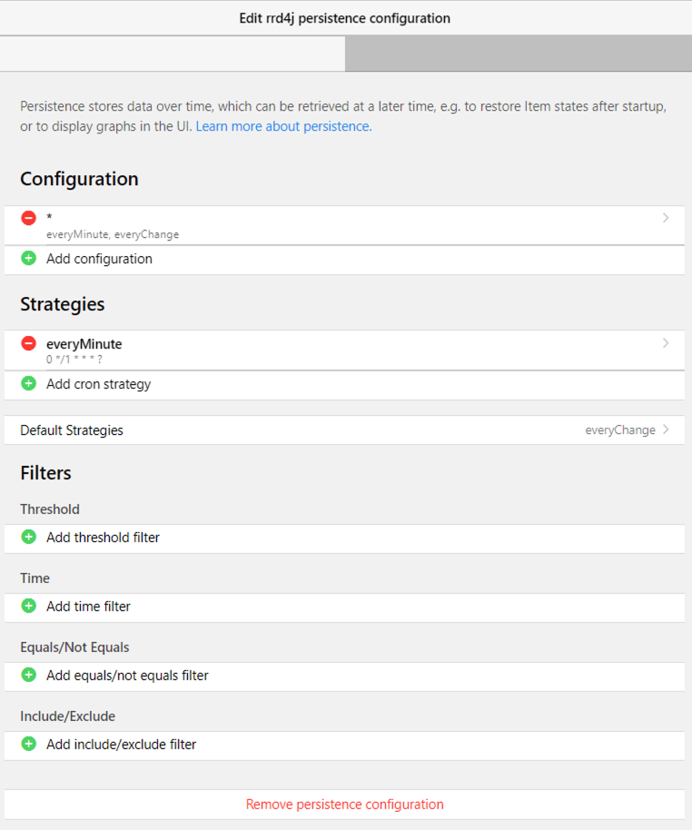

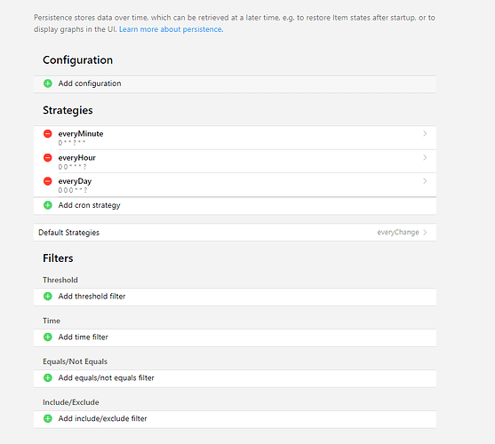

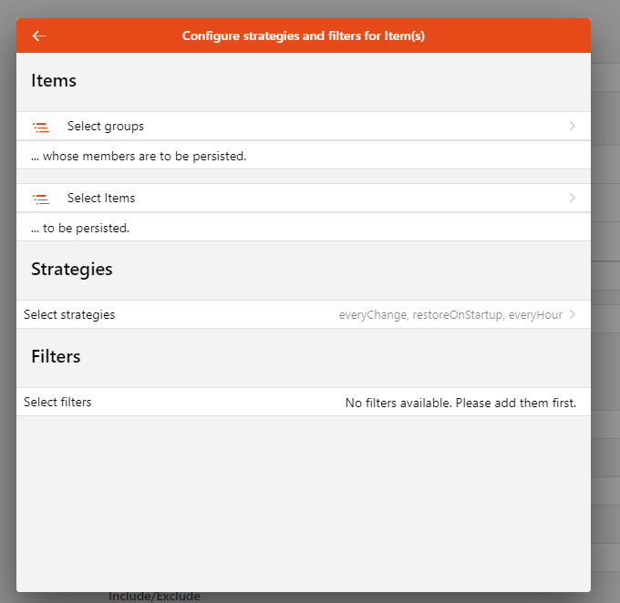

Anyway to configure persistence to exclude an Item through the UI:
Remove the * Configuration if it exists
Define all the strategies you may want. everyChange, everyUpdate, restoreOnStartup and forecast are built in. rrd4j requires at least an everyMinute strategy too. The UI has a nice cron builder that can help with coming up with the expression if you are not familiar with cron.
If you do want to apply some filters, define the ones you want. Note that filters work on the states of Items, they do not work on the Items themselves. You can’t use a filter to exclude Items from persistence.
Add a Configuration. If you followed @alda1’s advice and are using Groups, select the persistence Group under “Select groups”. If not, select all the Items you want to persist according to this configuration under “Select Items”. You can do both if desired.
Select the strategies to save these Items under. Again, for rrd4j you must choose at least everyMinute.
Select the filters to apply to these Items.
Repeat for the other confiugurations you need.

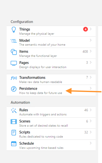

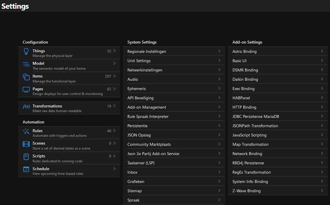

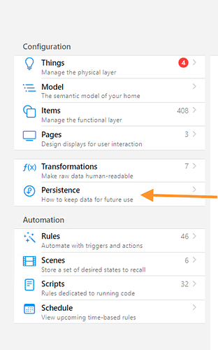

The persistence setting menu is a new setting entry coming with openHAB 4.2.0 and therefore not available for 4.1.0.
Persistence configuration via UI is available since openHAB 4.0, however it always was difficult to find, which luckily will change soon.
I lost track of when it was added. You’ll find the configs here in 4.2.

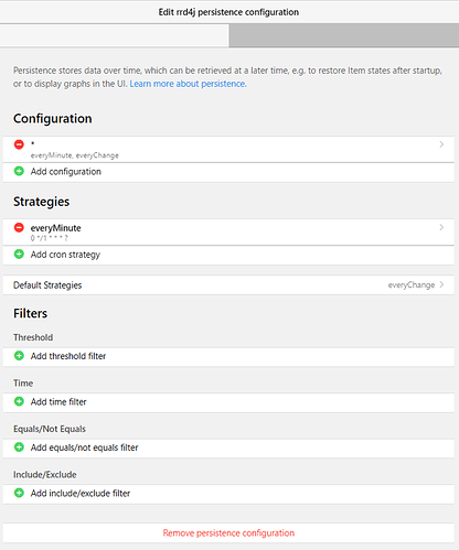

Yes, see the readme for the add-on. There is a default strategy which applies when there is no configuration. However, once you create a configuration, any configuration, that default becomes disabled.
Usually the default is “every Item everyChange and restoreOnStartup” with rrd4j adding “everyMinute” since that’s required for it to work.
No, because as far as I can tell you’ve not selected any Items. I don’t think the PR that adds the ability to select * for the Items has been merged yet so if you want every Item you need to click on the code tab and add it manually there.
But that’s not what was asked for in the original post. You want to exclude one or more Items from persistence. To do that you cannot use *. You have to select all the Items you want to persist, leaving out those you don’t want to persist.
And again, if you are using rrd4j, you must use everyMinute as a strategy. It will not work with everyDay or everyHour.
