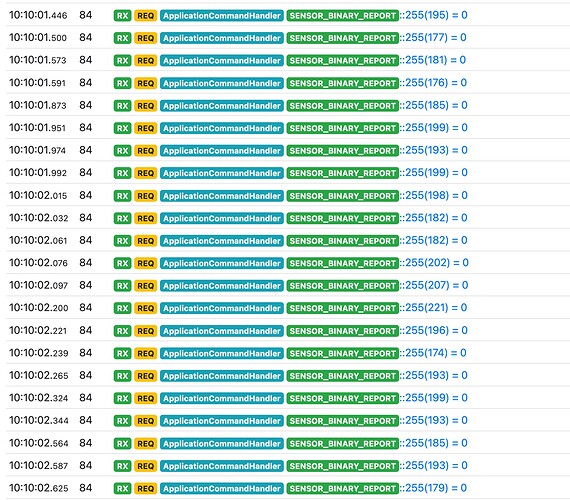

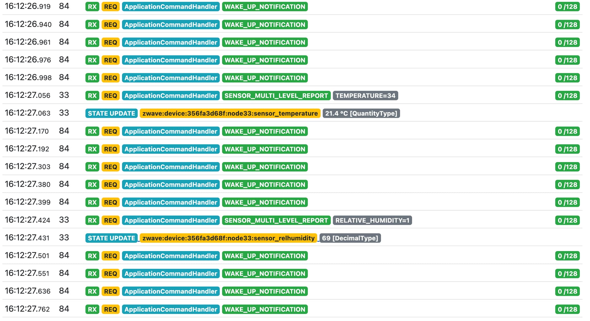

There’s some wierd stuff happening with node 84 -:

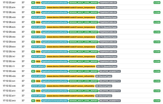

Likewise with node 37 -:

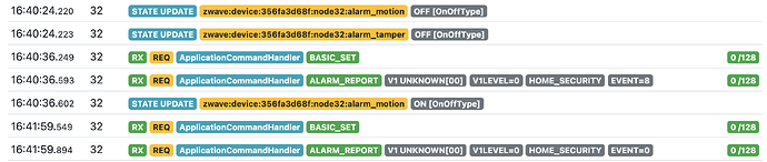

Node 32 looks mostly ok - it’s presumably a motion sensor and it’s triggering when people move around the house (I assume). I note though that it’s sending both the BASIC and ALARM reports - this might be something that can be reconfigured and the might halve the reports it sends.

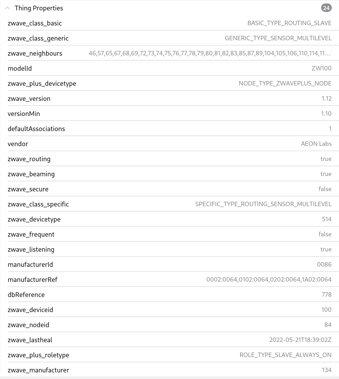

This is a USB-powered MultiSensor. It reports its configuration as follows:
Parameter 9 per the engineering specs states ā€œValue1 (MSB): 0x00=USB power modeā€. The thing properties:
Why would a wake up notification even be sent to it?
This sensor is some distance from the controller. I assume it’s re-sending frames that the controller doesn’t acknowledge.

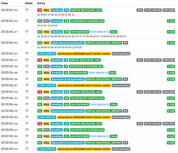

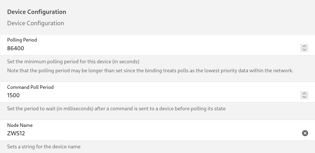

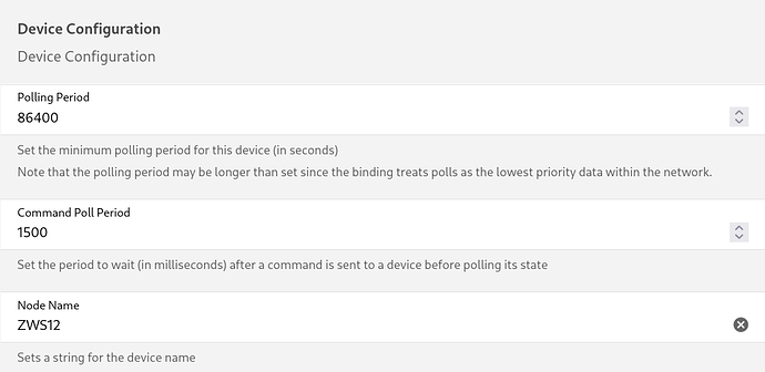

I have never modified the polling interval from the default, and they are always 86400 in the admin UI. Let’s take node 77:

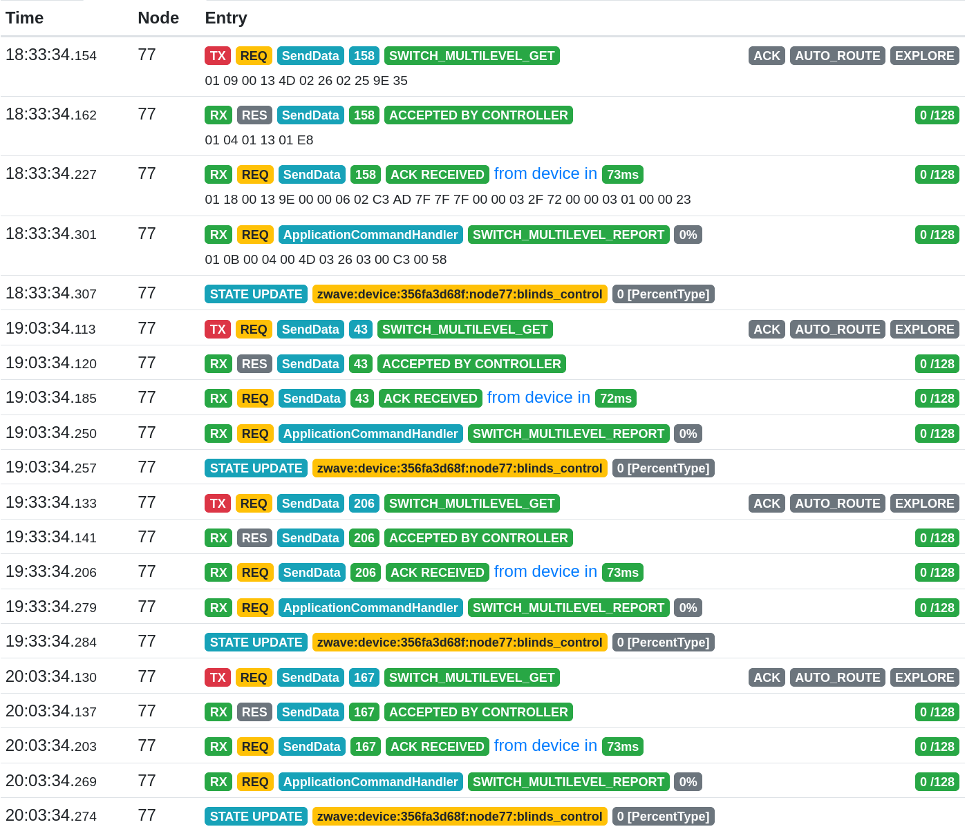

Here’s the log viewer for it, which shows 30 minute polls despite 86400 being the setting:
Anything else to try?
The notification is not being sent to the device - the device is sending it to the binding. Probably you have included this device when it was battery powered - it must be excluded, and then included with the power configured as you will use it. Currently the device is configured as a battery device - the device remembers the settings it had when it was included.
As above, the configuration is set to 30 minutes - I’d suggest to check that it’s not set like this in the devices (ie each device - not the default in the controller).
@chris Depending on what version he’s running, do you think he might be the victim of what you fixed with this PR?
Edit: The above PR was merged on March 12. So, if you are on a version of openHAB that doesn’t include that change, the polling interval will default to 1800 sec unless you set a new value by explicitly editing the polling interval in thing configuration.
Yes, quite likely, but the only way out I think is to change each device explicitly to a different value (or edit the json files directly, but that’s the same thing, implemented in a different way)
Or update to the most recent milestone (M5), which includes the fix. :wink:
I set all the devices to 86,399 seconds and restarted openHAB. This appears to have resolved the earlier issue.

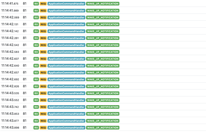

There are a few strange things I’ve spotted -:
This might be indicative of a problem with this device, or possibly an issue in the network.
Likewise with node 84 -:
So there are a few strange things here, but in general I don’t see any issues with the binding. I think it would be good for you to work through this - looking at the different devices to understand if traffic can be reduced (eg see if it’s possible to configure these sensors to only report one type of alarm). Maybe this isn’t possible, and it’s just a ā€œfeatureā€ of your household (eg quite a few motion sensors that are triggering quite often).

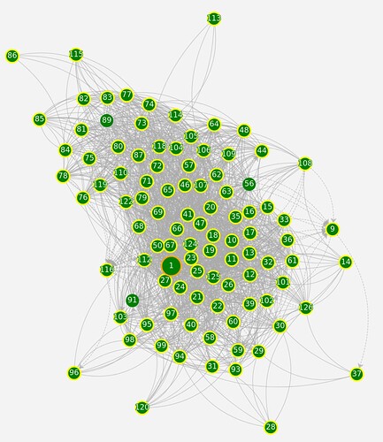

I’m not sure that splitting the network will help a lot - it may make things worse since you reduce your routing options. You will still have the same amount of traffic being sent though - the same reports etc. Splitting the traffic across two networks won’t reduce this, and as ZWave typically only uses a single channel (in practical terms anyway) the channel congestion at least will be the same. I think you’re better to try and use the viewer to understand what is happening with each device, and see if you can improve it. Devices that are misbehaving might require a reset to stop them flooding the network (this is something we do see occasionally) and reducing reporting where it’s not needed may also help.

The logs showing an alarm on then alarm off event very regularly is due to the configuration of the MultiSensors. They send a motion off event a configurable period after the last motion. For the MultiSensors I have this set to 60 seconds. A larger value is problematic as at night time I want the lights to quickly go off after motion ends. If I was designing this from scratch I’d pull in the data from alarm system PIRs instead. I have dozens of MultiSensors so it’s not really worth the effort at this point.
