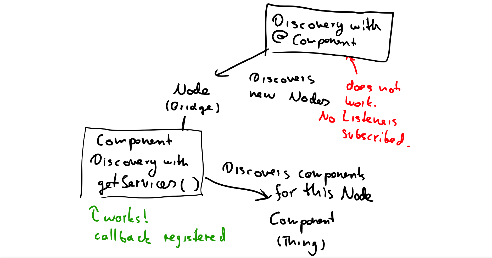

In the example above this is a Thing. But I have swapped to a different System. I now have Bridges with their own Discovery Services, as well as a Discovery Service for discovering Bridges.
The Discovery Services for the different Bridges work perfectly using the getServices( )-Method Override in the Bridge handler.
The “main” Discovery Service for the Bridges (using the @Component annotation) however does not work. I believe this is because openHAB does not add some callback to the DiscoveryListener, something that happens with the getServices( )-Implementation.

EDIT: I hope this Illustration makes it more clear
