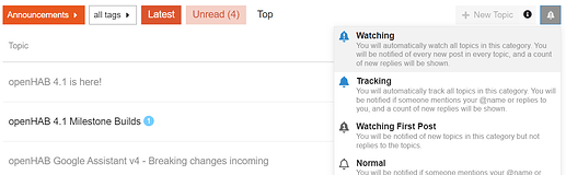

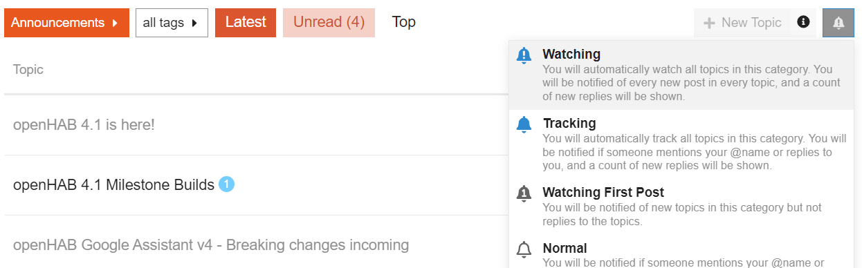

Yeah, I think that’s a great idea. I don’t see a “subscribe” option. Am I correct in thinking that you’re setting the Announcements category to “Watching”…
And then enabling “Email me when I am quoted, replied to, my @username is mentioned, or when there is new activity in my watched categories, tags or topics”?
The only downside I see is that there’s no way to only get the watched categories. It’s all or nothing. But that’s less of a concern for people who don’t visit the community daily.
Yes that is what I did, it’s normal to know at a topic level this exists, but my guess is most people do not know you can do it at the category level. You only get 1 to 3 a month so this works well at staying updated and I know exactly when the latest milestone is ready for download.

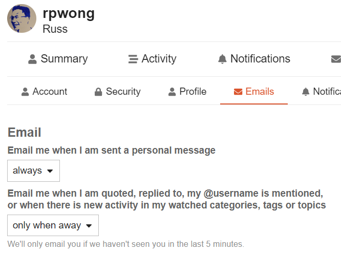

I definitely didn’t know it could be done on a category level. But don’t you also get emails whenever someone replies or @'s you?
@ yes
A direct reply to a post = yes
A reply in the thread = no
I use tracking level not watching on threads, like this one, so that no emails get sent unless it is a direct reply. Not sure if I changed the default somewhere to make it default to tracking.

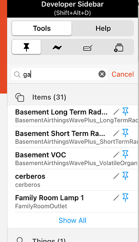

It might be worth mentioning that the Developer Sidebar in MainUI can search Item metadata. So if you search for “ga” you’ll get all the Items that currently have “ga” metadata. Unfortunately you’ll also get all the Items that have “ga” anywhere in the name or label of the Item too, but that’s still better than having to look through every one of your Items to remember which ones have the GA metadata.

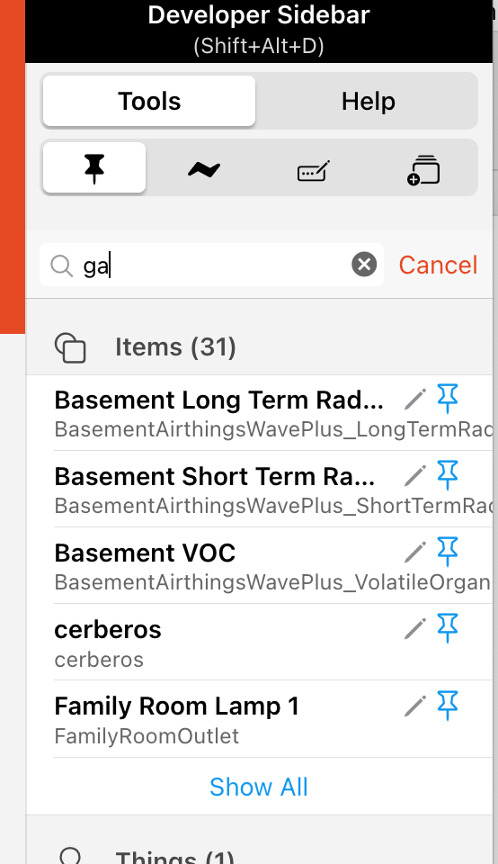

This does not work for me - or I do not get it…
The more tech-savvy people could also look into the REST-API, e.g. /rest/items/?metadata=ga and filter a bit :smiley:
Just in case there’s a step you are missing:

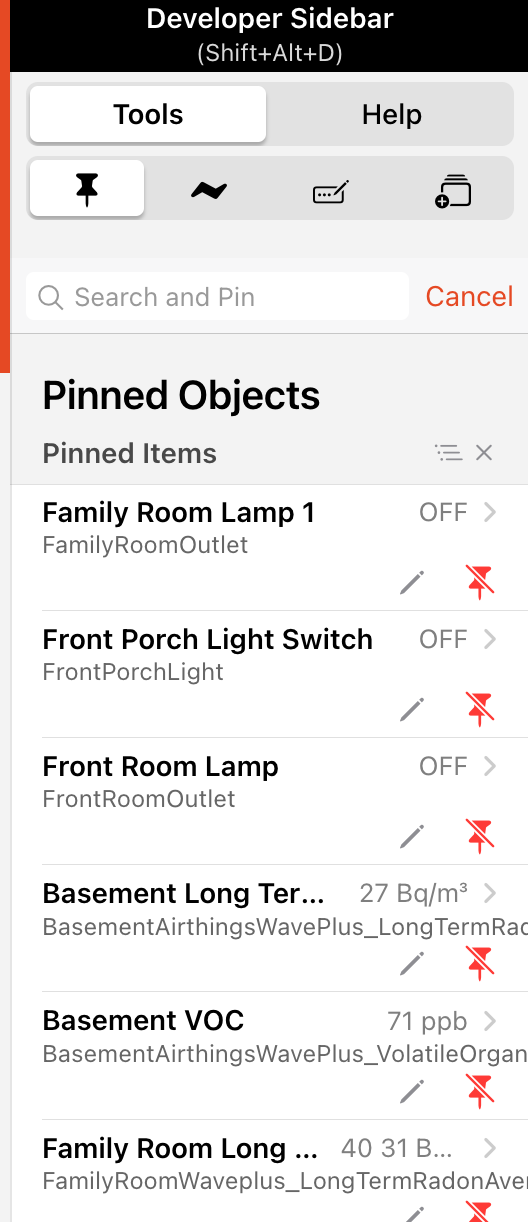

  1. Open the developer sidebar: alt-shift-d
  2. type “ga” into the search
  3. Click on “Show All” under Items and click the thumb tack icon next to each Item (skipping those you know for sure do not have the “ga” metadata.
  1. Click the gray “x” icon in the search box to clear the search. All your pinned Items will remain in the list.
  1. Click on the pencil icon next to the first Item in the list to navigate to the Item’s page. If it has “ga” metadata you’ll see it listed under “metadata”.
  1. Once the GA metadata has been verified and/or corrected, click the pushpin icon next to the Item in the list of pinned Items in the Developer sidebar to remove it from the list.
  2. Repeat 5-6 for the remaining Items.
Thanks a lot.
Unfortunately, my search is only giving me 5 results overall, which are definitely not all of my annotated items. Is this something that has maybe changed in OH4, because I am still on 3.4.
Yes, definitely. It wasn’t until OH 4 that Item metadata was added to the search support in the developer sidebar.
