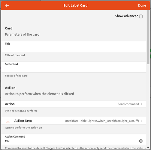

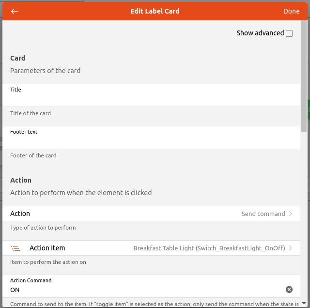

There is no such thing as a string card, so I assume that you mean an oh-label-card. Take a look at the label card doc page, you’ll see a section named Action. This is a list of all the things you can configure the label card to do when you push on it. You’ll note that most of them just impact the widget/interface (i.e., open popup, navigate, variable etc.). Only a few of these can actually directly impact something in the core system: command, options, toggle, and rule.
It sound like you want the command option which will send the specified command to the specified item (and it does not have to be the same item that the card is displaying in the label). You’ll need to only add two configuration options beyond Send Command: Action Item and Action Command:

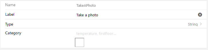

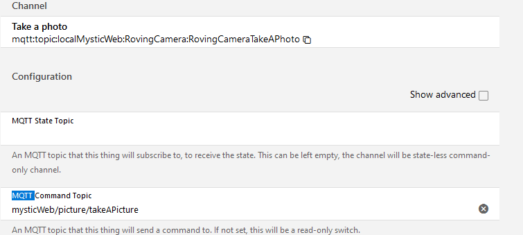

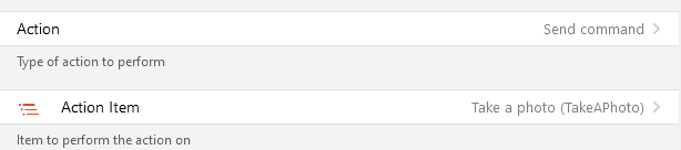

Here is what I have defined
Edit label cards
take a photo item
Take a photo channel
What command are you sending to your item? That’s not shown in the top image.
If you have Action, Action Item, and Action Command all configured, now what does the event log show when you click the label card?
Does the state of the item have to reset to some other value between commands (does your item have to register a change instead of just receiving a command)? If so, how are you accomplishing this reset?
What’s the Action Command? What command should the widget send to the Item when the widget is clicked on? You’ve cut that field off in your screenshot. My understanding is that is not optional. You have to define the Action Command too, not just the Item.
