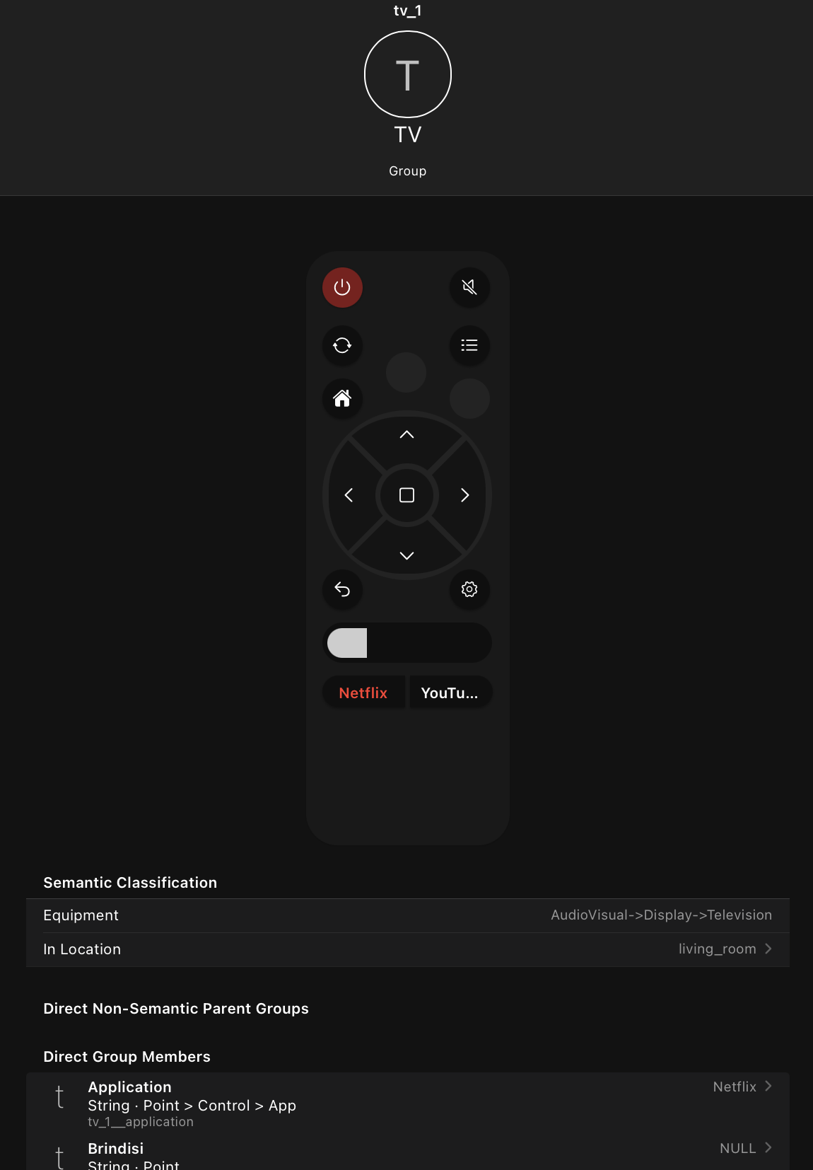

Display equipment as custom widget in auto generated pages

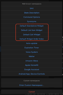

Hi all. I recently discovered how to represent items better in the MainUI, thanks to few examples I’ve found in the community.

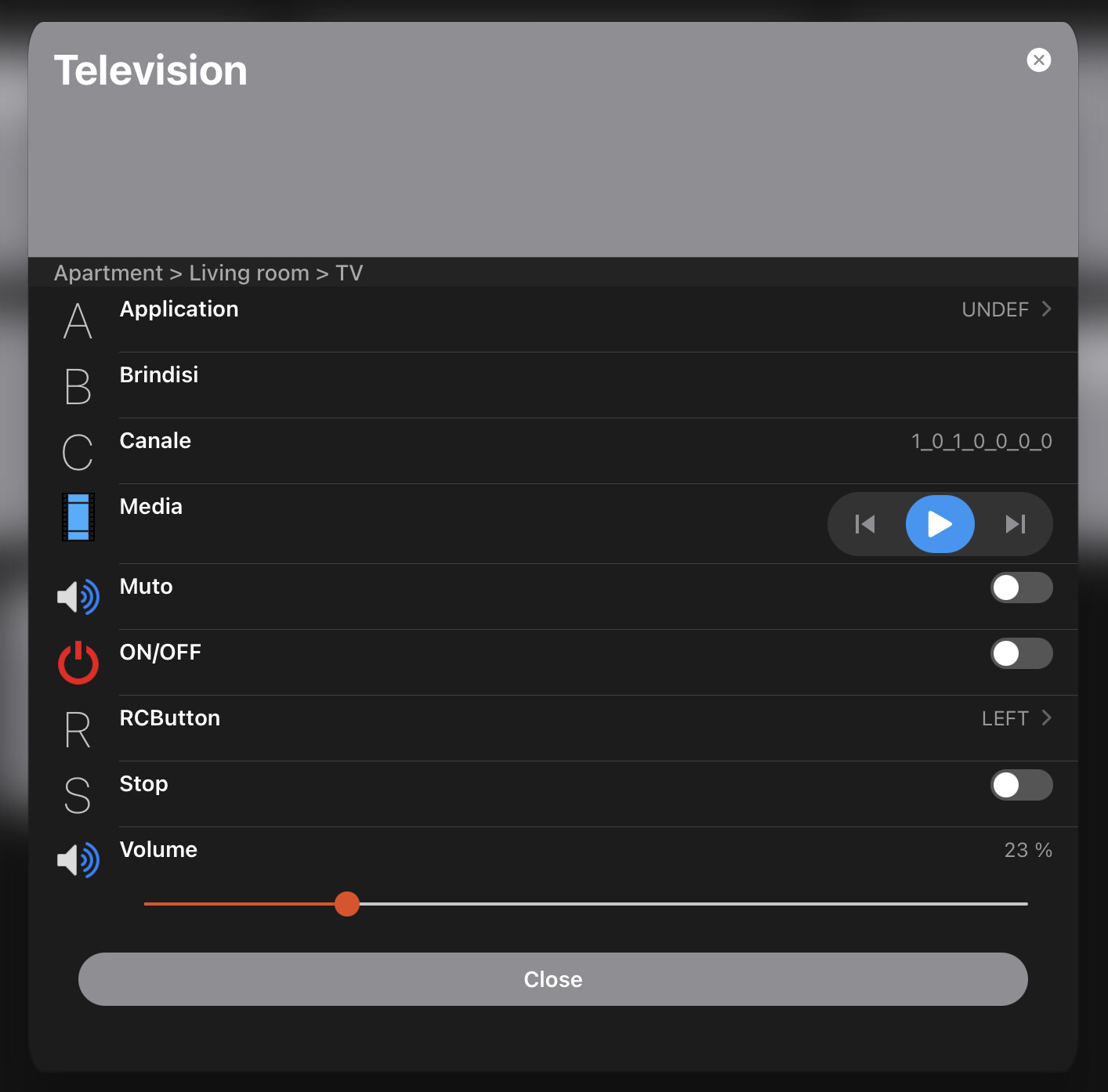

Now I would like to change –under Equipment>Television– a group item representing the TV remote of an LG WebOS using a custom widget I’ve whipped up, rearranging all the group members in a more accessible way.
I can’t seem to modify the metadata in a way that I achieve that. I’ve tried all the options circled in the picture below, but even after a lot of head scratching, I think I’m missing something. I do realise that the group item is not explicitly shown as an item in the semantic model because equipments are not shown as items, but I wonder if there is a way to achieve this. Am I actually trying to do something not possible?

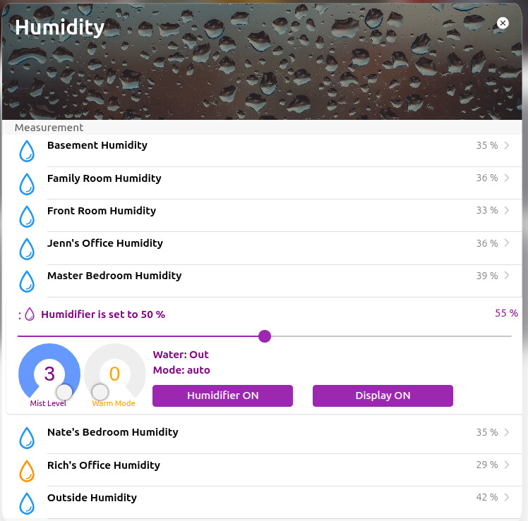

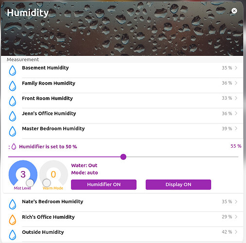

I created this widget to consolidate the controls for one of my smart humidifiers.

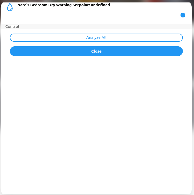

But because it’s larger than one row it breaks something in the framework and I end up with a bunch of extra space at the bottom of the card and I can no longer click the close or analyize all buttons. I’m pretty sure it’s because it’s not a list item widget.
Your widget will have the same problem. It will break any of the automatically generated cards it appears in.
But let’s say the problem gets fixed. The widget that gets displayed in the automatically generated cards are the “default list item widgets” so that’s the metadata that you need to use. And the root widget must be a list item widget (e.g. one of these 9 widgets. It cannot be a card. It cannot be a cell.
I suspect your widget is a card widget which works great placed on a page. But you cannot use it in one of the autogenerated cards because those ultimately are list item cards (i.e. they are a card intended to hold list item widgets, not just any old widget).
uid: levot_humidifier_list

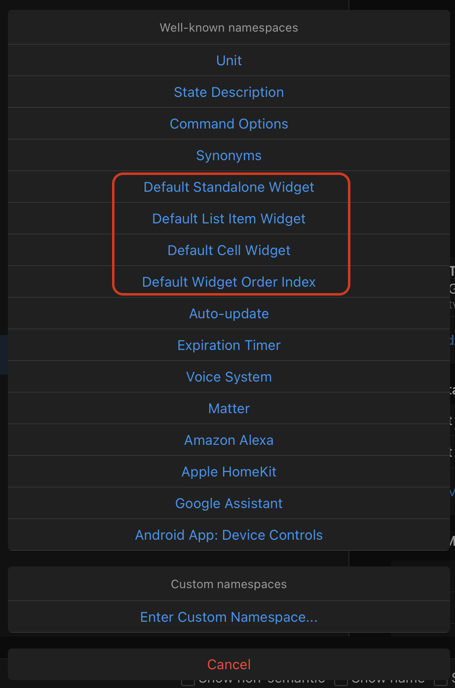

You might be able to use a couple of widgets that don’t take up much room to creates something reasonable. I created a couple of widgets to represent my chromecasts which are based on list item widgets and they combine multiple Items into one cell.
See Mediaplayer Now Playing and Control
Just make sure to set the default list item widget for all of the Items that are used with this widget, setting the visibility property to false for all but one of them. For one of them set to your custom widget.
You might need two or three widgets to fit everything in but that’s better than nine.

I suspect that you can work around this fairly easily with an f7-list-item-row.
If someone posts an example of one of these list item widgets that causes the problem, I can take a look.

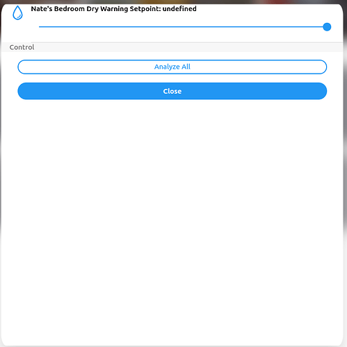

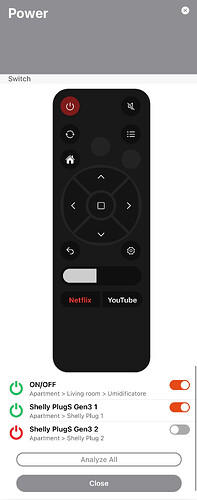

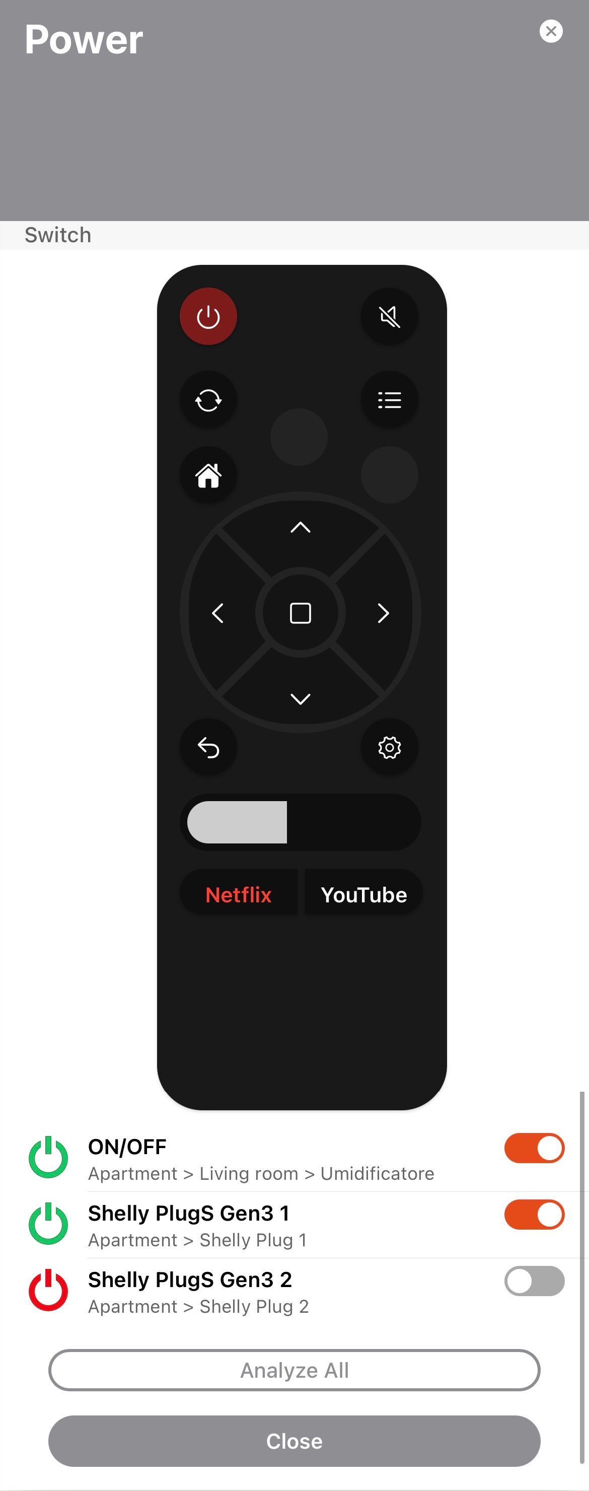

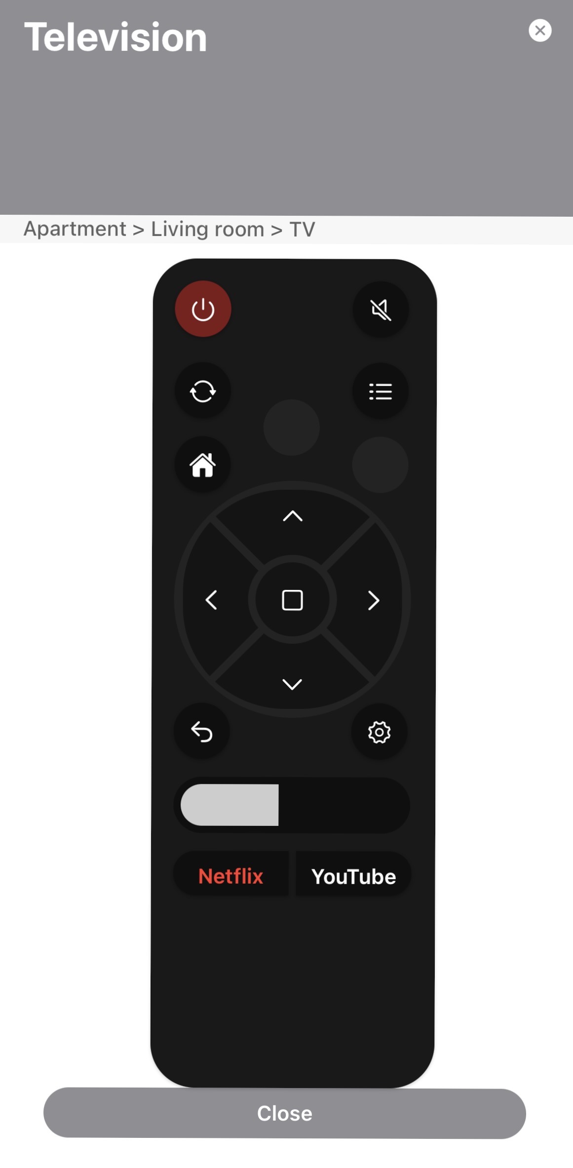

Wow, thank you @rlkoshak for the quick reply. Yes the widget I’ve made is the usual f7-card (YAML at the bottom), I thought that it was somehow possible to display the group items as cards instead of lists of members.
I wonder what would happen if I were to change the base component to what you suggest and maintain all classes and styling somehow… I will try later.

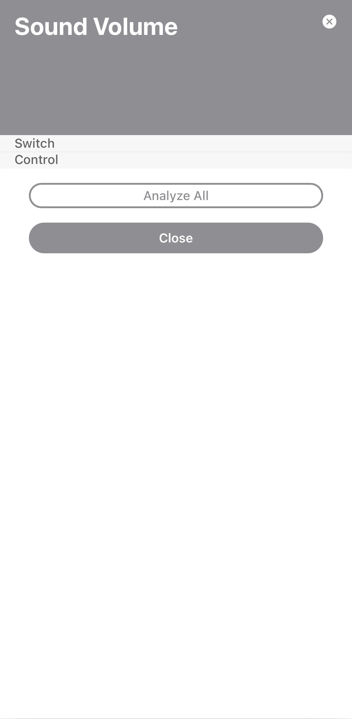

I wasn’t sure this could be an “elegant” solution, but tried your suggestion, and… everything works? It doesn’t seem to break everything, the widget takes up just the space I would expect it to.
All the cards buttons Analyse and Close under Properties tab are working fine: I changed the metadata of the power button, so the widget shows up in that property card too, but the analyse button works and shows every item. I have to admit I’m in the process of configuring persistence, so I might not see problems yet.

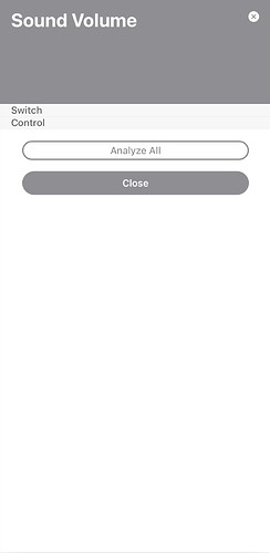

Again, in other properties cards though the items related to the television are hidden (as expected), but the Analyse/Close button works fine.
On second thought, I haven’t used any padding/margin in the card I’ve made, just a bunch of absolute positions, could those be influencing the overall behaviour of your page @rlkoshak?

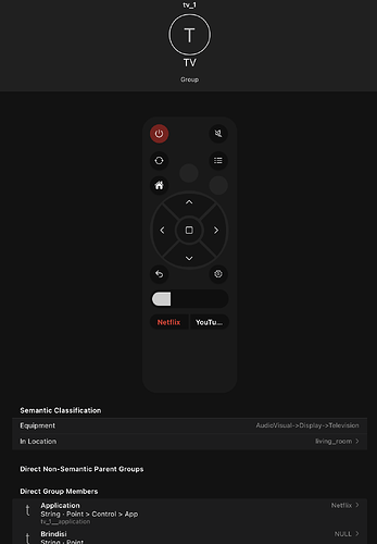

@JustinG not sure my example could help you, but
here is the remote widget I am using
uid: widget_247c2c9eb0

I posted the YAML for the humidifier widget I use above (the levot_humidifier_list code).
Here’s another one, this time for a thermostat:

It’s been a long time since I coded these and I am now realizing that they both are f7-cards which instead of list items which might actually be the root cause of the problem. But I have a vague recollection that the existing list item widgets didn’t have the flexibility for me to lay things out. But that’s is likely my own lack of skill more than a limitation of the widgets.
:person_shrugging: I’m really far from being an expert on MainUI widgets. I don’t use the UI much at all so it’s mostly an exercise in trying stuff out to see what works and doesn’t when I hav time and time is pretty scarse these days.
It’s kind of weird that mine have the problem but your’s does not. Clearly I’m doing something weird or unexpected. Perhaps it is the offsets.
Yep, the f7-card is 100% of the issue. F7 lists (and oh lists, therefore) are just unordered list elements and so prefer list item child elements. Nothing about the f7 library wraps items placed in a list in an <li> element by default (the child elements take care of this). So, the items themselves have to have <li> as the root element in one way or another or the list winds up with some degenerate html. In this case, the issue is not that the card disables the lower parts of the list, it’s actually just rendered above them because the card’s contents container winds up without proper sizing and overrides things further down the list. The buttons still work; you just can’t click them because the invisible part of the card is in the way.
Yeah, your recollection is entirely accurate. Most of the f7 list components have all manner of internal formatting that makes a general widget impossible, but that’s where the f7-list-item-row comes in. It’s basically just a blank container with the <li> root and the minimum required bit of f7 sugar on top.
I think you’ll get the results you’re looking for most directly with just a few quick changes:

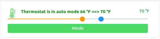

Getting this working properly coupled with the fact that my thermostat now has an upper and lower setpoint gave me the little push I needed to rework my thermostat widget posted above. Not only is it fixed to not break the overview cards, I decided to take advantage of oh-context and wow does that make it easier to create reasonable widgets. Here is the new version (I’m a little embarrassed by the version above now).
uid: new_thermostat_list

                    style:
                      position: absolute
                      top: 35px
                      width: 90%
                    unit: =props.units
                - component: oh-button
                    action: options
                    actionItem: =const.thermoItems.mode
                    color: "=const.modeColor[@@const.thermoItems.mode] || gray"
                    fill: true
                    style:
                      position: absolute
                      top: 60px
                      width: 90%
                    text: Mode
I need to do this to the rest of my widgets eventually. Long term maintainability will be much better.
I’m also posting it here so that one can see the full solution in context.
Thank you a lot @JustinG for the help. It took me a while to understand the implementation with the accordion slot, but now I have managed.
For anyone that like me is not that skilled, I post my troubleshooting here. From the code of the widget I published above:
  • The behaviour of the accordion doesn’t work well because of
    • Class card-content-padding is preventing the accordion from fully closing.
    • The vertical margin of the card class has also to be set as zero, otherwise the accordion will not fully close. So set –f7-card-margin-vertical: 0px under style
  • What @JustinG meant with this is that once I try to open the accordion, the accordion will show as open, but the it will look as closed. The absolute positioning of all the content I had inside the f7-accordion-content “detaches” the components from the “canvas”, so when the accordion opens and is expected to size up, it “doesn’t see” any component on the page.
It took me a couple hours to realise this, but as solution I decided to not touch any position attribute, and instead create another f7-badge, with position attribute relative, with same geometries of the page, and superimpose it, adding under style the z-index: 0 (I had other components with indices starting from 1, so I tried to see if 0 was allowed).
Final revised widget code (if @JustinG blesses it) is here:
TV remote widget
uid: widget-TV_remote
tags: []
props:
  parameters:
    - context: item
      description: The members of the group TV item will be pulled automatically.
      label: Television
      required: true
      type: TEXT
      groupName: remoteItems
  parameterGroups:
    - name: remoteItems
      label: Select TV item.
timestamp: Nov 5, 2025, 3:48:50 PM
component: f7-list-item
  title: Television
  accordionItem: true
  accordionItemOpened: true
  default:
    - component: f7-accordion-content
        style:
          --f7-card-margin-horizontal: 0px
          --f7-card-margin-vertical: 0px
          border-radius: 30px
          width: 12rem
          height: 35rem
          left: calc(50% - 12rem/2)
        class:
          - card
        default:
          - component: f7-badge
              style:
                background-color: rgba(25, 25, 25, 1)
                position: relative
                left: 0px
                top: 0
                width: 12rem
                height: 35rem
                border-radius: 30px
                z-index: 0
              iconF7: power
              raised: true
              large: true
              textColor: white
              action: toggle
              actionCommand: ON
              actionCommandAlt: OFF
              actionItem: =props.tvItems + "__switch"
              class:
                - align-content-center
              style:
                background-color: rgba(126, 26, 26, 1)
                position: absolute
                left: 15px
                top: 15px
                height: 38px
                width: 38px
                border-radius: 50%
              iconF7: house_fill
              raised: true
              large: true
              textColor: white
              action: command
              actionCommand: HOME
              actionItem: =props.tvItems + "__RCButton"
              class:
              style:
                background-color: rgba(15, 15, 15, 1)
                position: absolute
                left: 15px
                top: 120px
                height: 38px
                width: 38px
                border-radius: 50%
              iconF7: chevron_left
              raised: false
              large: true
              textColor: white
              action: command
              actionCommand: LEFT
              class:
                - text-align-left
              style:
                background-color: rgba(20,20,20,1)
                position: absolute
                left: 21px
                top: 155px
                clip-path: polygon(0 3%, 0 97%, 100% 50%)
                transform: rotate(0deg)
                height: 150px
                width: 70px
                border-radius: 75px 0 0 75px
                z-index: 2
              iconF7: chevron_right
              raised: false
              large: true
              textColor: white
              action: command
              actionCommand: RIGHT
              class:
                - text-align-right
              style:
                position: absolute
                left: 99px
                top: 155px
                clip-path: polygon(0 50%, 100% 97%, 100% 3%)
                height: 150px
                width: 70px
                border-radius: 0 75px 75px 0
                z-index: 2
              iconF7: chevron_up
              raised: false
              large: true
              textColor: white
              action: command
              actionCommand: UP
              style:
                position: absolute
                left: 20px
                top: 156px
                clip-path: polygon(3% 0, 97% 0, 50% 100%)
                height: 70px
                width: 150px
                border-radius: 75px 75px 0 0
                z-index: 2
              iconF7: chevron_down
              raised: false
              large: true
              textColor: white
              action: command
              actionCommand: DOWN
              class:
                - align-content-flex-end
              style:
                position: absolute
                left: 20px
                top: 234px
                clip-path: polygon(3% 100%, 97% 100%, 50% 0)
                height: 70px
                width: 150px
                border-radius: 0 0 75px 75px
                z-index: 2
              iconF7: square
              raised: false
              large: true
              textColor: white
              action: command
              actionCommand: ENTER
              class:
              style:
                position: absolute
                left: 70px
                top: 205px
                height: 50px
                width: 50px
                border-radius: 25px 25px 25px 25px
                z-index: 4
              style:
                background: rgba(35, 35, 35, 1)
                position: absolute
                left: 65px
                top: 200px
                width: 60px
                height: 60px
                border-radius: 50%
                z-index: 3
              iconF7: arrow_uturn_left
              raised: true
              large: true
              textColor: white
              action: command
              actionCommand: BACK
              class:
              style:
                position: absolute
                left: 15px
                top: 300px
                height: 38px
                width: 38px
                border-radius: 50%
              iconF7: gear_alt
              raised: true
              large: true
              textColor: white
              action: command
              actionCommand: IMPOSTAZIONI
              actionItem: =props.tvItems + "__application"
              class:
              style:
                position: absolute
                left: 135px
                top: 300px
                height: 38px
                width: 38px
                border-radius: 50%
              style:
                position: absolute
                left: 15px
                top: 350px
                height: 38px
                width: 160px
                border-radius: 19px
          - component: oh-slider
              min: 0
              max: 100
              step: 1
              releaseOnly: true
              item: =props.tvItems + "__volume"
              style:
                position: absolute
                left: 20px
                top: 350px
                height: 38px
                width: 150px
                border-radius: 20px
                --f7-range-knob-size: 0px
                --f7-range-bar-size: 28px
                --f7-range-bar-bg-color: rgba(15, 15, 15, 1)
                --f7-range-bar-active-bg-color: rgba(205, 205, 205, 1)
                --f7-range-bar-border-radius: 28px
              text: Netflix
              raised: true
              large: true
              textColor: red
              action: command
              actionCommand: Netflix
              style:
                position: absolute
                left: 15px
                top: 400px
                height: 30px
                width: 78px
                border-radius: 15px 0 0 15px
              text: YouTube
              raised: true
              large: true
              textColor: white
              action: command
              actionCommand: Youtube
              style:
                position: absolute
                left: 98px
                top: 400px
                height: 30px
                width: 78px
                border-radius: 0 15px 15px 0
              style:
                icon-f7: circle
                position: absolute
                left: 15px
                top: 150px
                width: 160px
                height: 160px
                border-radius: 50%
                z-index: 1
              style:
                background-color: rgba(35, 35, 35, 1)
                position: absolute
                left: 135px
                top: 120px
                width: 38px
                height: 38px
                border-radius: 50%
                --f7-badge-text-color: rgba(200,200,0,.5)
                z-index: 1
              iconF7: arrow_2_circlepath
              raised: true
              large: true
              textColor: white
              action: command
              actionCommand: Home Dashboard service launcher
              class:
              style:
                position: absolute
                left: 15px
                top: 70px
                width: 38px
                height: 38px
                border-radius: 50%
              iconF7: list_dash
              raised: true
              large: true
              textColor: white
              action: command
              actionCommand: Guide
              class:
              style:
                position: absolute
                left: 135px
                top: 70px
                width: 38px
                height: 38px
                border-radius: 50%
              style:
                position: absolute
                left: 75px
                top: 95px
                width: 38px
                height: 38px
                border-radius: 50%
                z-index: 1
              iconF7: speaker_slash
              raised: true
              large: true
              textColor: white
              action: toggle
              actionCommand: ON
              actionItem: =props.tvItems + "__mute"
              class:
              style:
                position: absolute
                left: 135px
                top: 15px
                width: 38px
                height: 38px
                border-radius: 50%
