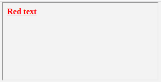

On further thought, I take it back. There is a fairly easy solution. As I stated above, you can use arbitrary html tags in widgets. So you should be able make you own iframe widget and use the srcdoc attribute to have the iframe parse your item html:
- component: iframe
    srcdoc: =@@'nameOf Your HtmlItem'
That still doesn’t solve the css issue (although at that point you might be able to put a .css file in your /conf/html folder append a header to your html string with a style element pointing to that sheet and avoid a CORS issue, but I haven’t tried).
Thanks, that goes in the right direction! I was able to create an own widget with this config and could display the text without html code. As you described the standard browser font is used that does not look really nice. I will try to inject my own CSS file.

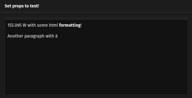

You can also try using the f7-text-editor component which can display sanitized html:
component: f7-text-editor
  buttons: []
  value: =@@'PCBureau_Power' + " with some <i>html</i> <b>formatting</b>!<p>Another paragraph with &auml;"
There doesn’t seem to be an easy way to make it read-only though, maybe that could be achieved with some CSS or some other technique:
Turns out you can inject the css into the iframe directly in the widget without worrying about css file. Here I use an oh-context mostly to make the css string prettier in the widget editor, but you could just make it all one big long expression in the iframe if you wanted to:
uid: iframe_css
props:
  parameterGroups: []
  parameters: []
tags: []
component: oh-context
  constants:
    styleDirective: >
      <style>
        .bold-text {
          color: red !important;
          font-weight: 900;
          text-decoration: underline;
      </style>
    simulatedItem: '<span class="bold-text" style="color: green;">Red text</span>'
  default:
    - component: iframe
        srcdoc: =const.styleDirective + const.simulatedItem
This is almost the solution I liked to achive, thanks!
The small line in the header of the invisible editor buttons and that it is still an editor not a read only text are not perfect, but I can live with that. Also good that html is alredy sanitized (also if some people perhaps like to have working hyperlinks)
Would be really cool if main UI would provide such kind of cell one day so it would be really easy to display some html formatted text.
Also a solution that is usable if there is no need for aditional files. Many thanks for trying it out!
But I have not managed to extract the needed css to get the same visual impression than the rest of the page yet but it should be possible with fidling around a bit longer with the necessary css.
Please try this:
It should solve both your problems.
Example usage:
component: f7-card
  title: Test HTML widget
  default:
    - component: widget:html_display
        html: =@@'PCBureau_Power' + " with some <i>html</i> <b>formatting</b>!<p>Another paragraph with &auml;"
        stylesheet: >
          .text-editor {
            border: 0;
            background: transparent;
Sounds promising but I could not make it work as desired. It was still editable and button header was visible. I used my previous defined f7-text-editor widget from your previous post as default-component, right?
Do I also need to add a f7-card-content? (But the text there is not using the html tags)
