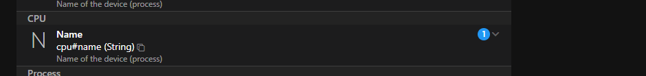

For CPU i only have name, not uptime or anything else
