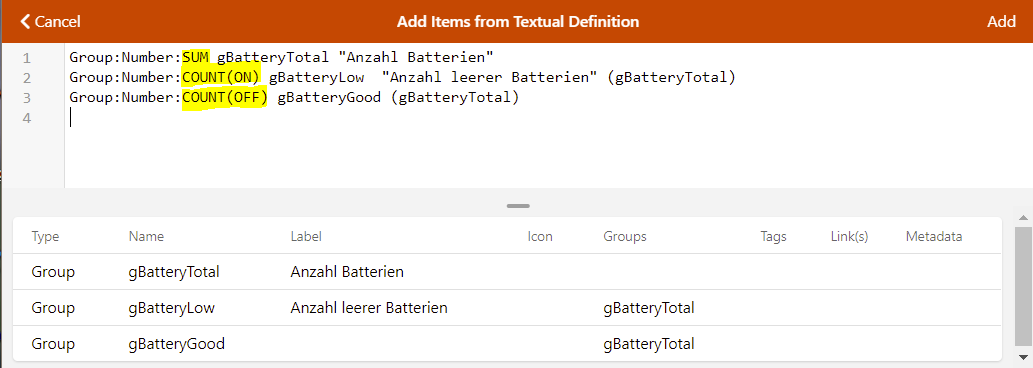

It is not my solution but it is all in the link. OP is using three groups, one for OFF and one for ON, the third is a sum of both :
This essentially adds two groups where one counts for empty and another count for good batteries.
A third group simply sums up the both which provides me the total number of batteries:
NumOfEmptyBatts + NumOfGoodBatts = TotalNumOfBatts
All BatteryLow-items belong to both count-groups - that’s it

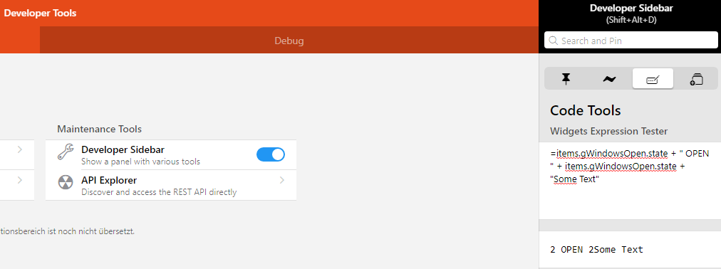

Dumb me, sorry, my fault again, needs to be
footer: =items.gMiners.state + "OFF"  + items.gMiners.state + "Some text"
You can always check expressions with the developer tools
