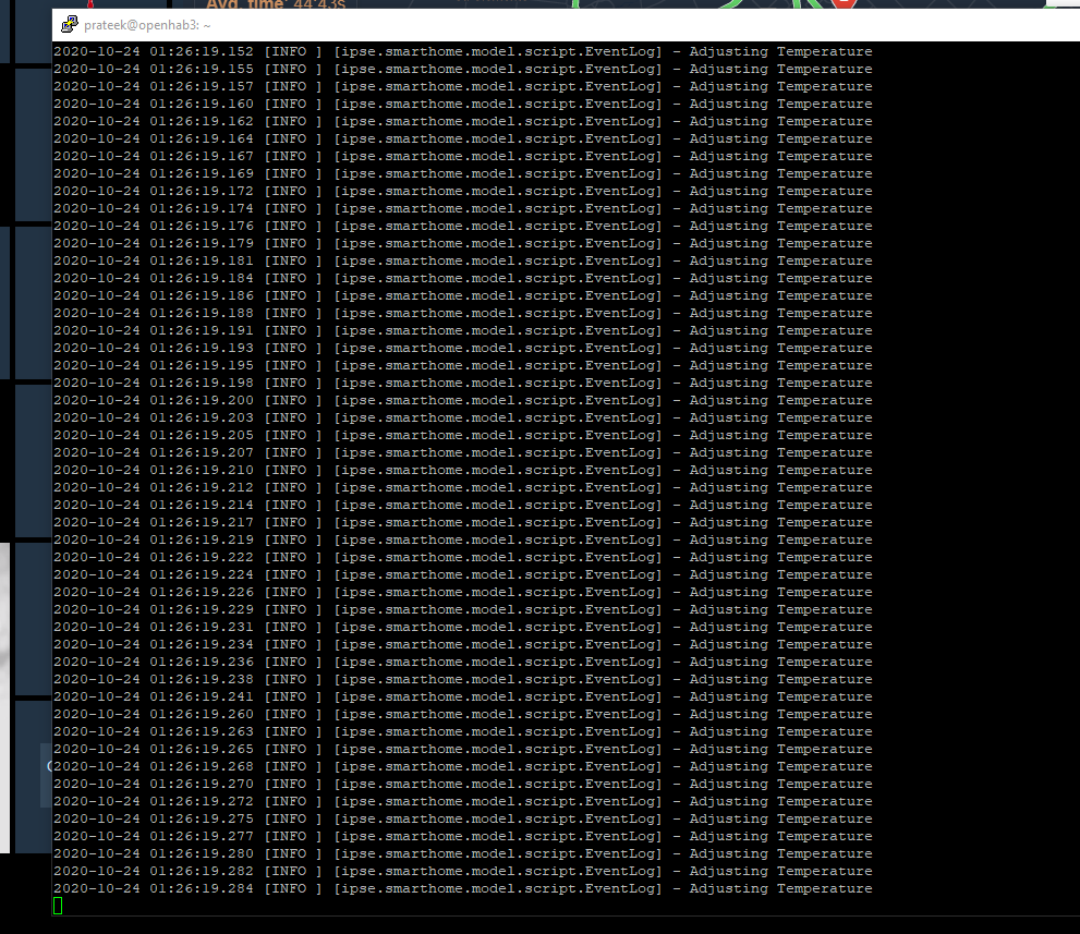

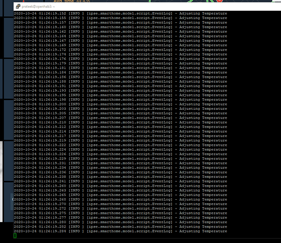

holy shit were you guys ever right…bruuuutal loop right now
So i guess the first thing to do is stop this from happening.

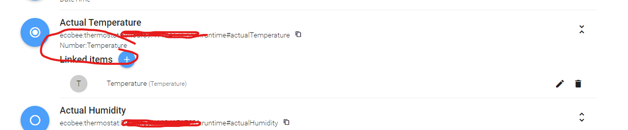

It does indeed actually specify as a Number:Temperature
However, if I do this, then I get a syntax error and it doesn’t display correctly

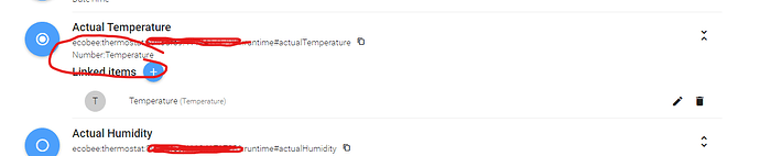

I didn’t actually change it to Number:Temperature because that causes it to not display correctly.
Here is the problem if I use it as a Number:Temperature.
Yes it shows up correctly as Celsius in the PaperUI, however it does not in HABpanel.

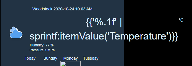

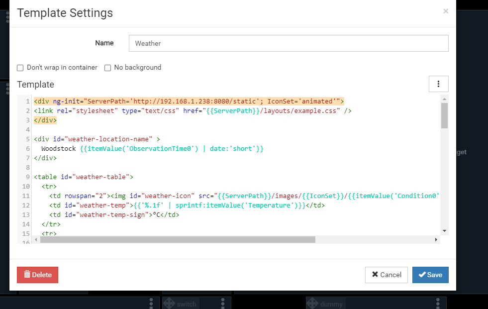

As for the HABPanel, I should mention that I’m using a templated widget (HTML-code) not a dummy frame. Hence, I do not have the option to “use server supplied format”
(Line 12 is the one that isn’t working as a Number:Temperature)
I will say that it displays correctly if I use a dummy frame, but I’m trying to get it working in this nice widget that displays multiple temperatures.

Can’t help with that; apart from a reminder that the value from Item state is not a float number , it comes with the units text. So %.1f is not going to work in your sprintf.

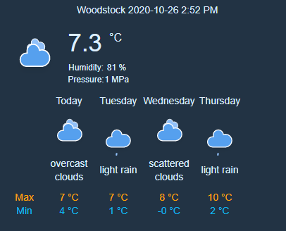

Well after everything, I have solved the problem.
The key is how the HTML code in my template was defined.
This is how I had to format it to take into account a float number.
Here is the modified code
{{'%.1f' | sprintf:itemValue('Temperature').split(' ')[0]}}
After the Temperature, I had to add
.split(’ ')[0]
This allowed it to work correctly.
Marking as Solved.
You could of course have used %s, as you already specified the decimals you wanted in the item [state presentation]
