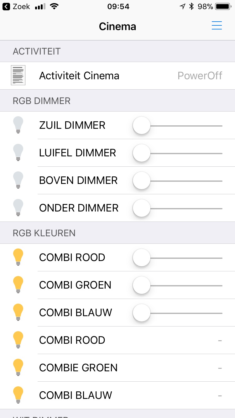

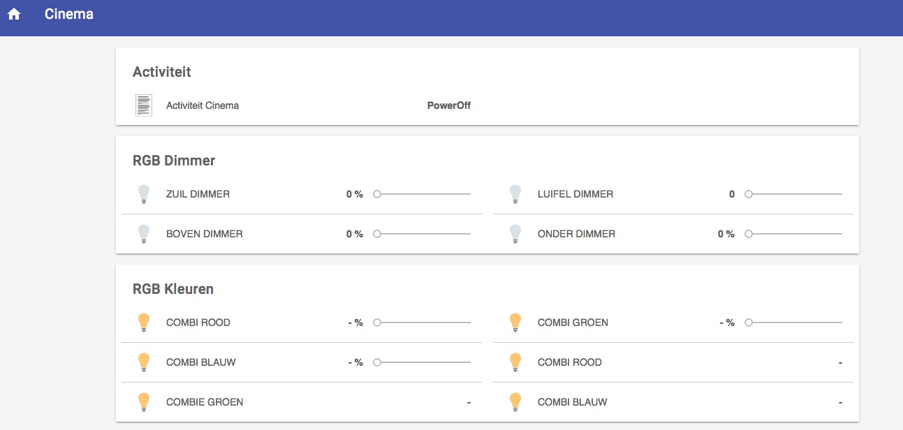

I have similar problem showing values of a slider in the sitemap. The value is shown when I open the sitemap in a browser via BasicUI. But when using the iOS app, the value is not shown. Any thoughts?
Syntax used (all sliders are the same):
items:
Dimmer ZuilDimmer “ZUIL DIMMER” {knx=“12/4/1+<12/4/2,12/4/3,12/4/4+<12/4/5”}
