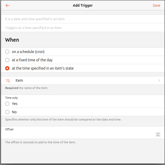

You missed the part where I said “state Channels”.
Each solar event (e.g. Nautical Sunrise) has four Channels: start time, end time, duration, and range event. The first three can only be linked to Items. The event Channel cannot be linked to an Item.
Note that solar events have a length. They are not instants. They all have a start time and an end time. The event Channel will get START at the start time and END at the end time, meaning if you trigger a rule using this Channel, that rule will get triggered when solar event starts and then again when it ends.
If you want to change trigger the rule when sunset starts, link the Start Time Channel to the DateTime Item and use that Item to trigger the rule with a Time is Item trigger. If you want it to trigger at the end of sunset, use that Channel instead. Not you can also add offsets to the Channels so you can get 30 minutes before the start of nautical sunset, for example.

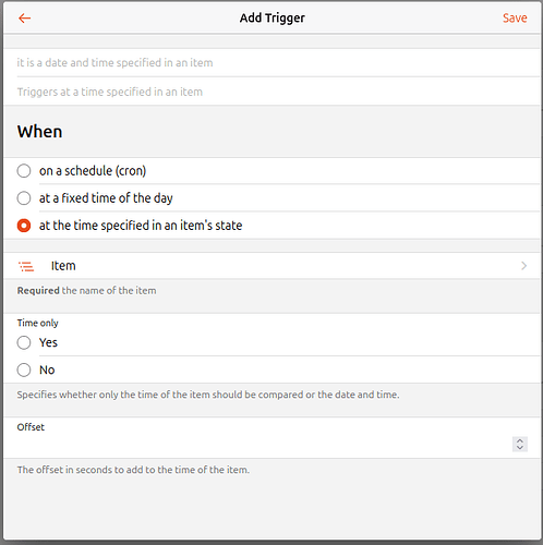

Then you used the wrong trigger. You triggered the rule when the Item changes., You need to use the “Time is Item” trigger.
