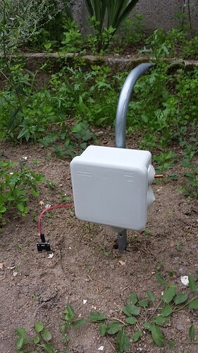

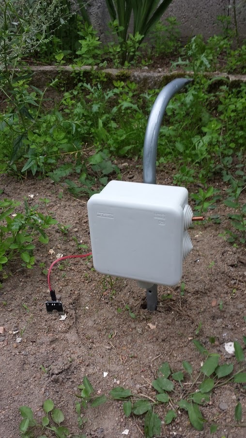

I have build an external waterproof sensor integrated with openhab based on Atmega328p (arduino heart).
Main characteristic is low power (6 micro amps when not sending data) which theoreticaly give a life of around 8 years to the sensor (I’m lazy don’t want to change batteries and don’t like to waste energy :slight_smile: ).
It is sending temperature, humidity, soil hygrometry and battery voltage every hour so as to monitor my garden environement.

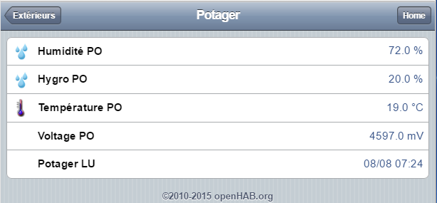

Here is how it looks like into OH:
The RF used is 433Mhz with emitter powered only when sending data (same thing for the sensors), data is sent as a numerical value to a 433Mhz gateway that forward the data by MQTT with ethernet to OpenHAB.

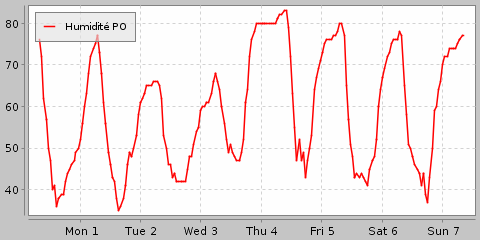

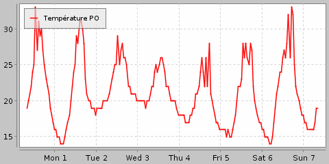

Data are persisted, here is some views.

Hi @fog the soil moisture sensor is working since 2 month now, I can’t say that I have a long term experience unfortunately. Here is the data coming from this sensor in particular:
Working good at the moment and no sign of aging but interested on your feedback with the capacitive approach.
