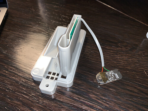

I found a solution to help rain sensor and ZigBee magnetic contact to make such a gauge.
Unfortunately, the tutorial is for HomeAssistat, and although very detailed, I can’t convert the configuration for HA to OpenHab.
I would need to create a configuration or a script (if at all possible) how to convert the pulses from the ZigBee magnetic contact to the amount of precipitation per hour per day and display this data in a graph.

I still have the same sensor lying here as a component, but never really managed to build a really reliable rain sensor out of it. I never really managed to de-bounce the reed switch properly (frequent double counts or phantom counts). Did you manage to solve this in hardware on your end?
