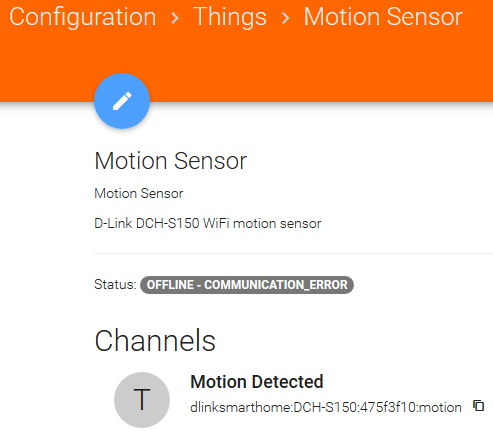

I have purchased this sensor today and just hooked it to my wifi. Works well within MyDlink app, detects movement quicker then originally anticipated.
Next step is to add to openhab (version 2.4.0-1). Then installed D-Link binding. Binding could not discover sensot automatically so had to add it manually, correct IP address and Pin code from the box.
However it is still showing communication error offline see attached graphic below. I have not linked any items yet but as I far I am aware it should be visible as ONLINE, unless I`m missing something.
What does openhab.log have to say about it? The binding should produce initialization messages.
Can`t find many records in log file related to this sensor apart from this INFO
2020-03-29 15:04:52.374 [INFO ] [g.discovery.internal.PersistentInbox] - Added new thing 'dlinksmarthome:DCH-S150:908d78a119ab' to inbox.
An update - retyped sensor pin code once again and still didn`t worked. Then restarted openhab service and thing has changed status to ONLINE so it works now :wink:. Not sure why restart was required.

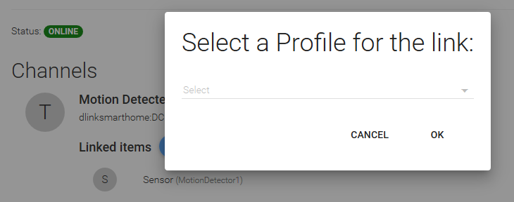

In Paper UI is asking me to choose profile when attempting to link an item…
Not sure about this profile, anyone know this ?
Maybe I over complicating this, only need to link this item and display it in sitemap
Use default profile.
Thanks for the suggestion, it is not allowing me to enter a profile name and there aren`t any profiles to select from drop down menu.

That means your Item definition is nonsense. You cannot link a trigger channel to an Item state (which is probably why PaperUI wouldn’t let you do it). The docs don’t suggest linking to Item anywhere.
