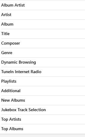

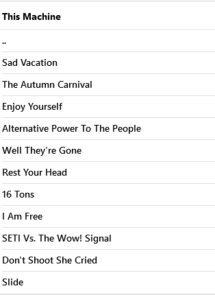

I would like to use DLNA/UPNP binding to control my AssetUPnP server on which my CD collection is stored. I have created a small widget that lists the contents of the AssetUPNP server.

- Is it possible to access the link for ‘Albumart (Albumcover)’ in addition to the text information (band name, album name, title etc.)? The data is at least listed in the debug log.
- After selecting a song from an album (last level of the listing), the first level of the server content is displayed again (Artists, Genre..). Can this be prevented so that the complete song list of the CD is always displayed?
Any idea is welcome.
