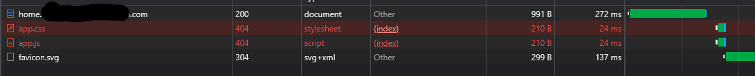

The normal site works, if i click the link to a dashboard the site stays white and my console is showing me this:
