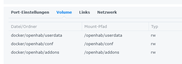

Also from VS Code I can access the things I created via an apiToken (they are listed on the left side under “Things”) which I created from the PaperUI. But if I open the corresponding folders, to edit the items for example, in VS Code they are empty (only readme and empty subfolders are inside).
I added a mount as in the install manual link to /volume1/docker/openhab/conf
My settings are the same as described in the manual
If you have any ideas to config the save path from paperUI or transfer my settings, please help

I ran into the same issue. You need to put *\opt* before *openhab*
I wasn’t even able to download addons until I changed the path.
pretty sure it’s /opt, not \opt, as it’s a GNU/Linux System, not Windows…
