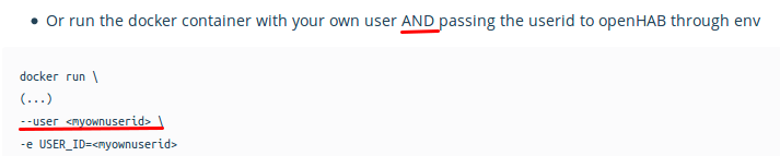

Hi @hannibal29
Thanks a lot for your guideline.
Unfortunately I missed your post so I tried it on my own. My experience is, that step 1 and 2 worked for me as well. For step 3 I used the docker UI on DMS. Additional to the default settings I had to define the volumes passed to container and set the USER_ID environment variable. Setting the GROUP_ID as described in the docker install page failed, because the passed group ID was already in use on the container.
Your approach by using docker compose seems to be more flexible than the docker UI. So I will give it a try.
Best regards
Raphael
I can confirm this. Setting group ID also broke my container.
