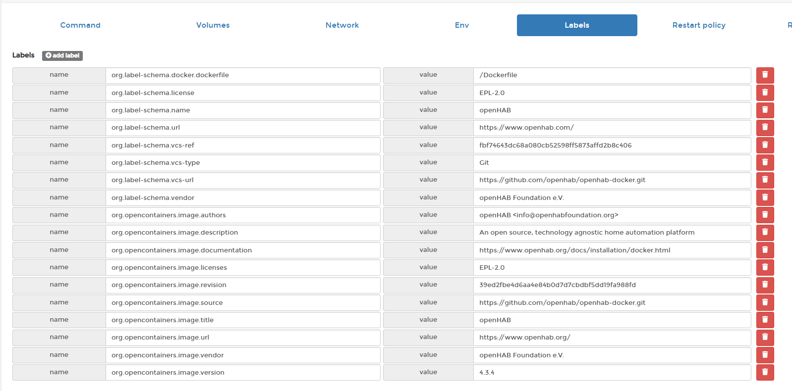

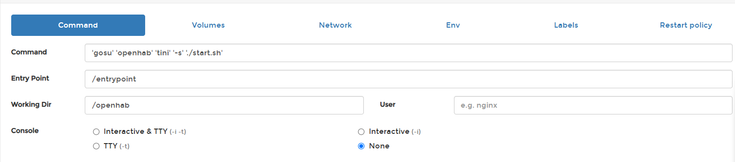

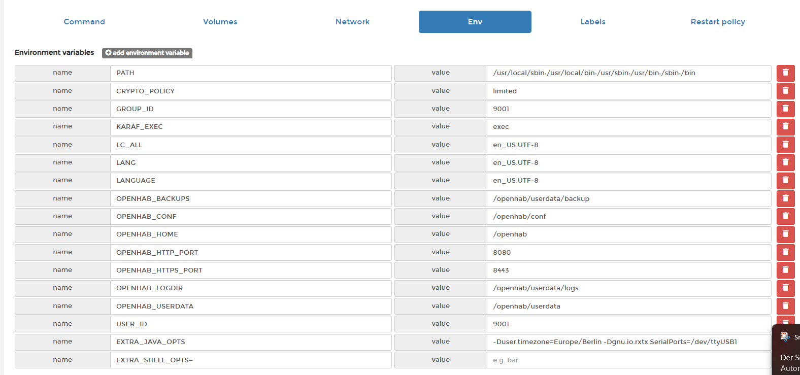

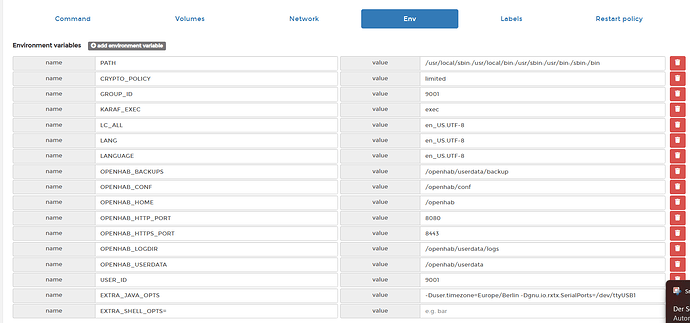

Attached my Docker Configuration:
I tried to install a clean docker with new configuration. The same error appears.
