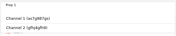

Im still missing a solution for the dropdown field with predetermined values. This could be a good tool to provide the community with easy-to-manipulate widgets.
You are 100% correct. Unfortunately when an easy solution isn’t available hard solutions must be sufficient.
Until someone volunteers to write this particular documentation, it’s the best we’ve got.
That can be achieved with a simple TEXT property and the options key:
  parameters:
    - name: prop1
      label: Prop 1
      type: TEXT
      description: A text prop
      options:
        - value: as7g987gs
          label: Channel 1
        - value: gfhj4gfh9
          label: Channel 2
