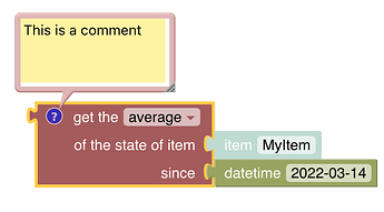

I just wanted to add a note that Blockly already supports adding comments as a property on a block. Right click on the block, choose add comment and
You can show and hid the comment as desired. But the above lets you create always visible comment blocks which is different. I just didn’t want people to think that this library exists because comments in general are not supported.

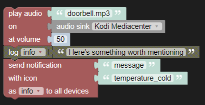

Another note: you can disable a block with the contextual menu as well, it will then appear in gray/brownish and won’t output any code, like so (see the “log” block color)
If you ever want the rule to actually log the message you can simply reenable it.
But those comment blocks are nonetheless valuable!

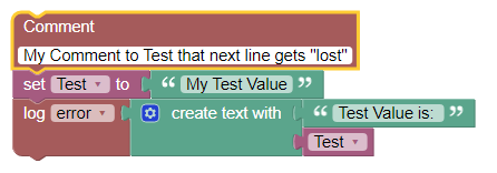

Can you post a pic of the exact block order you are using so I can test it?
Hi. Yes, I am using the simple rule as follows:
This generates:
var Test;
//My Comment to Test that next line gets "lost"Test = 'My Test Value';
console.error(('Test Value is: ' + String(Test)));
Which I believe should be:
var Test;

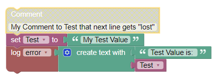

This set does work:
var Test;
EDIT:
I manually made these changes which seems to have helped, so maybe they need to be applied to the published version?
seeing that helps I will double check it is possible I missed an update needed in this last revision. Stay tuned
The latest version has the fix for your issue. Thanks for reporting.
