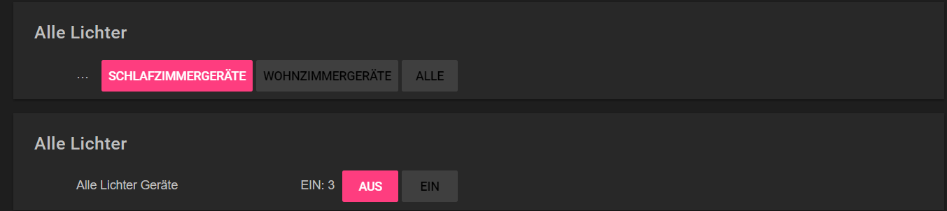

I have these 3 Buttons:
Number Group_preset (gLight) →
			Item gLight received command ON
		if (Group_preset.state === null)
		{sendCommand(gLight, ON)}
		else{
		switch (Group_preset.state){
		//all sleepingroomlights
		case 1:
		sendCommand(gLight, OFF)
		sendCommand(Yeelight1_p, ON)
		sendCommand(Yeelight2_p, ON)
		//all livingroomlights
		case 2:
		sendCommand(Yeelight1_p, OFF)
		sendCommand(Yeelight2_p, OFF)
		//all lights
		case 3:
		rule "reset preset"
		Item gLight received command OFF
Group_preset.state = null
Goal is to shut down some of the items of the gLight group, if one preset is selected.
But they just go crazy and I don’t know why, the logic should be allright.
Can someone help me?
