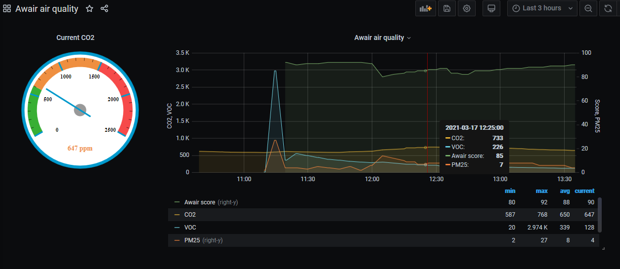

For OH2.5 I got the data into Grafana for charting and gauges without using a binding. I still would like a binding to reduce the coding.
I enabled the local API option for the Awair using the app and then in openHAB setup HTTP caching and regex to extract the needed data.
eg cache http://192.168.1.6/air-data/latest
