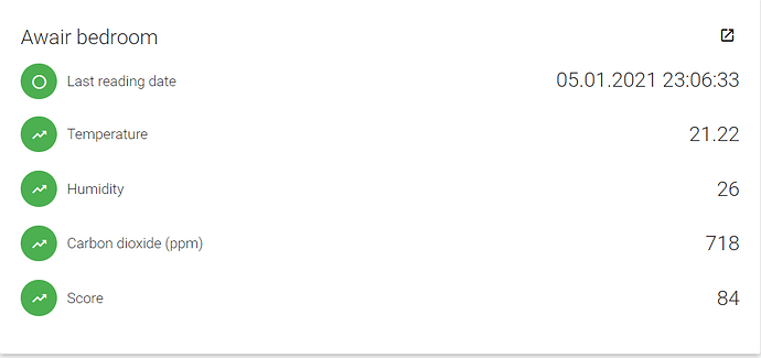

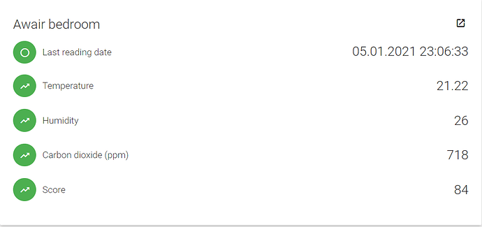

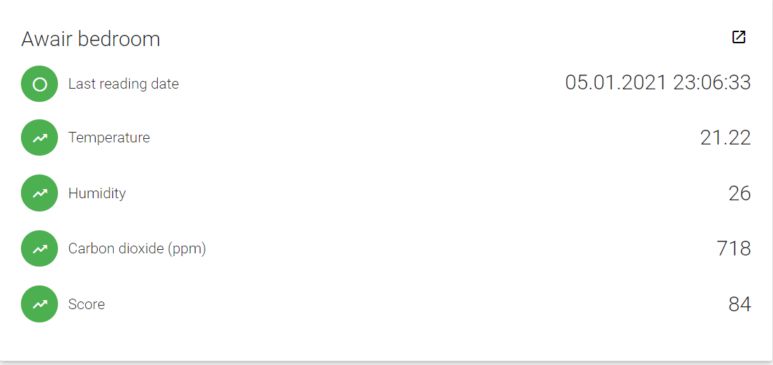

Here’s where the units don’t appear (PaperUI):

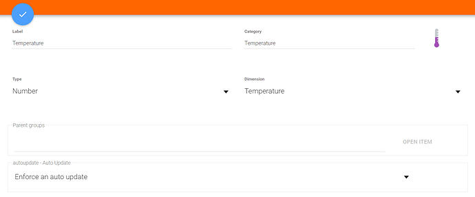

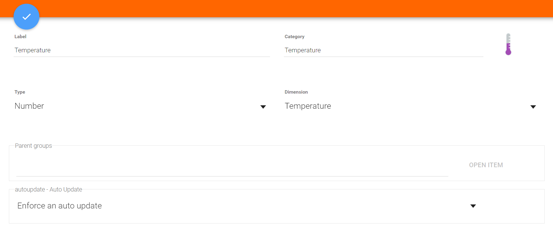

This is the item definition for temperature in PaperUI:
I’ve compared it to other temperature items that are showing the unit correctly in other bindings, and it seems to be the same.

The code looks fine to me. So I suspect it be a PaperUI problem. You could check if it is also a problem when showing items in BasicUI. Also PaperUI isn’t a good test environment since it has been removed in openHAB 3. So if you see anything wrong in PaperUI better check other UI’s or switch to openHAB 3.
In that case I suppose I’d better try upgrading.
