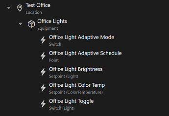

Now, when I put these points into an OH3 semantic model like so:
I get this when I open the location page for the “Test Office”:
As you can see, all the points are displayed, however, I don’t always want this. Some rooms have 5+ individually controllable lights so there would be 25+ items in a long scrolling list and users would need to scroll through and hunt down the exact light they want. Instead, in this case, I want only the toggles to be visible with a little expansion button so that if users want to override the automatically set brightness, they can press and see the “expanded options” for that specific light. In other cases, for example rooms where there is only one light, I want the option to show the toggle switch and maybe the brightness slider by default.
