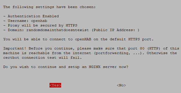

This is an example when using a random domain that doesn’t exist:
As you can see, the setup tool just doesn’t bother and continues, while the domain given (randomdomainthatdoesntexist) isn’t checked.
Another possibility why the script continues without an error message could be that the public IP address that is returned by the script is not correct either - the script only continues without that error message if both values match.
