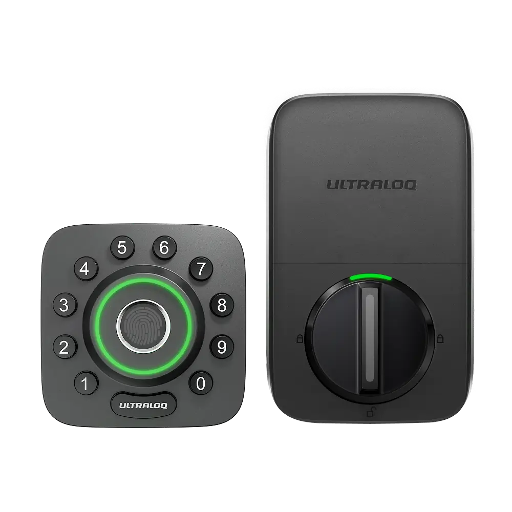

Googling ā€œZ-Wave fingerprint door lockā€ gave me a pretty quick answer. I don’t know where you live, so maybe it’s not available in your region.
I can’t say how this works exactly, since I don’t have one. I would guess that the BT/WiFi connection is needed for setting up the fingerprint recognition, and then it can also communicate directly with a Z-Wave controller.

Of course I also found this lock but it is only for US market and I don’t think I can check for face recognition before the lock will open.

The only locks I have found are Ultraloq (the one mentioned above), which is only for North American market.
