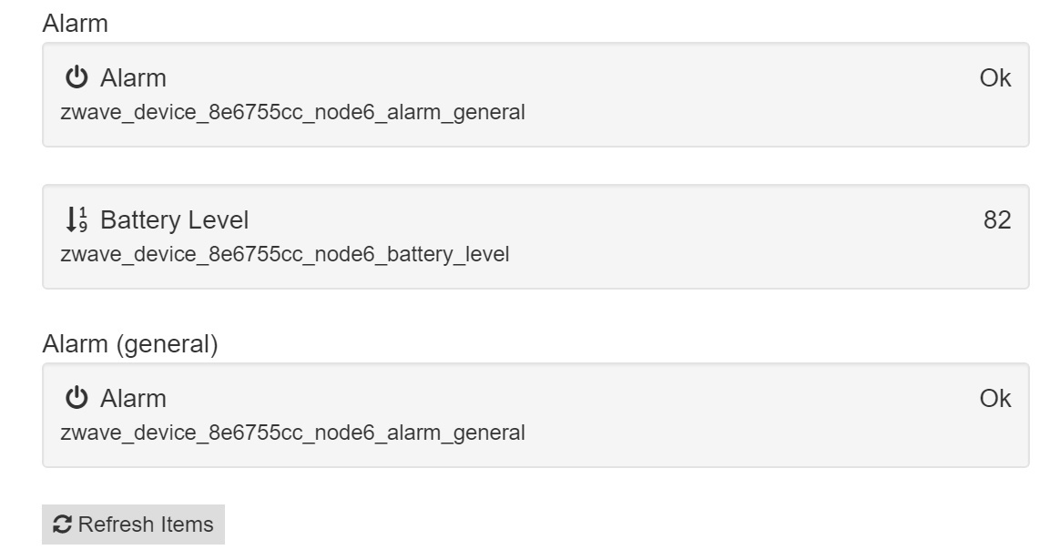

You can see in the image that I get a status on the Alarm and also on the battery level but not on the Binary Sensor which is the door contact. I configured it also as switch (which is the default) but no change

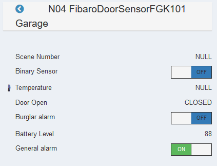

I recently also included a Fibaro FGK101 DoorSensor and I get OPEN/CLOSED Info.
I show you my config, so you can compare it to yours.
At the moment I got this:
In events.log i can see this:
2016-12-30 04:14:02.947 [ItemStateChangedEvent ] - N04FibaroDoorSensorFGK101Garage_DoorSensor changed from OPEN to CLOSED
2016-12-30 04:14:07.415 [ItemStateChangedEvent ] - N04FibaroDoorSensorFGK101Garage_DoorSensor changed from CLOSED to OPEN
My config looks like this:
(in the HABmin-device-configuration-description the items are immediately updated when changing)
(Edit: Association Groups: Lifeline = openHAB Controller)

Thanks for the help guys. After checking I see I do not have the door sensor
I only have those
Have you manually created that item ?
I did not create anything manually. Everything got automatically created during the introduction of the sensor in the z-wave network

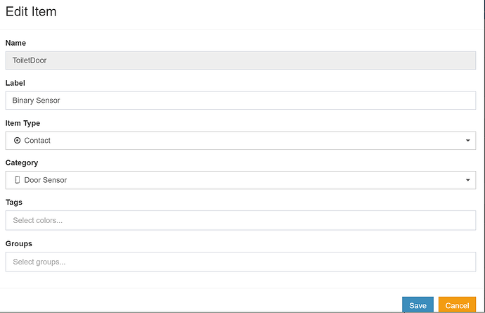

edit: As you can see in my first post I already tried to change one channel (binary sensor) to a contact but I still get nothing reported
You cannot do that, you need to use the default. If the devices item is recognized as “Switch”, you need to use switch, if it is “Contact”, you need to use contact.
See above, two different devices are available.
In openHAB2 you may have auto discovered devices, manually created devices or a mix of both. It is up to you how you want to use it. So if you prefer the auto detection, that’s fine.
So in your above setup, you need to concentrate on the “Binary Sensor”, create an item for that channel, display it on your sitemap and make sure association group Lifeline is set to your controller and it should work.
If not make sure the device is fully initialized and/or take a look in your openhab.log to see what is going on.
I even don’t have that device, only the older one
As I can see you have a “Last Wakeup Time”, that is good.
I don’t know why you only have 5 channels available, my older one has 9 channels available.
I would do: delete the thing, check /userdata/zwave if node6.xml is gone, if not delete it (save it somewhere), start discovery for zwave and after detection add the thing again … then wake it up several times until the node6.xml is recreated and it should have all channels (hopefully).
