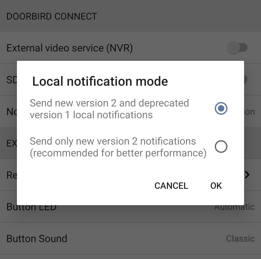

@DeepstarTOR Did you have to enable v2 encryption in the app?

I use two channels from the Doorbird (doorbell, doorbellimage) and in the Doorbird app it is still set to send v2 and v1.

Note: Unless you specify ONLY v2 notification events in the Doorbird app, the binding will process duplicate events, one for v1 and one for v2. So I think it would be advisable to specify v2 events only.

Doorbird set to version 2 only, but still I get the message:
