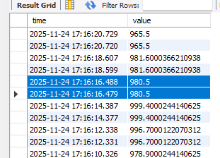

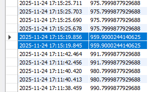

My persistence (JDBC with mariaDB) does insert double on everyChange:

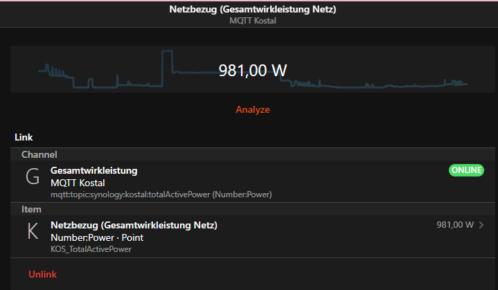

the items are only linked to one thing:

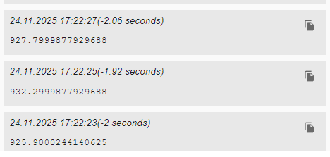

and the thing listens to a mqtt-topic, which definetely only gets updated once every 2seconds:
There’s only one openHAB instance running, and I triple checked as I just restarted the container, there was a gap in the persistence during the restart-process:
What do i miss here?
It affects as far as I can see all items, regardless the binding?
