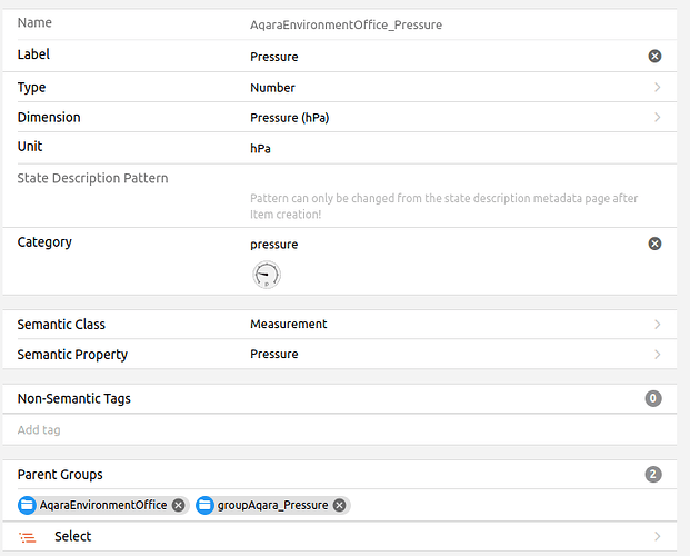

Currently I’m using OH4.2.0.M3 and facing with an issue. Perhaps is was also existing in OH3.4 but never recognized.
I’m using some Aqara sensors and others as well. Connected via Z2M. In many cases I see a doubled display of UoM.
What I have done in the most cases was to add a state description.
%.2f %unit%
But I’m sure this can’t be the solution at all. This means that I need to “fix” all items. Is there perhaps an other configuration issue at my end?
Thx, markus

This is no widget. This is only the item configuration in OH.
In the item “list” it looks correct…
… but within the item not…
And yes ofc, if I add the item to pages to some oh-labled cells I also have the doubled unit if I don’t use the state description.
That’s a strange behavior… never seen this before… :person_shrugging:
Me too. That’s why I’m asking here… :slight_smile:
