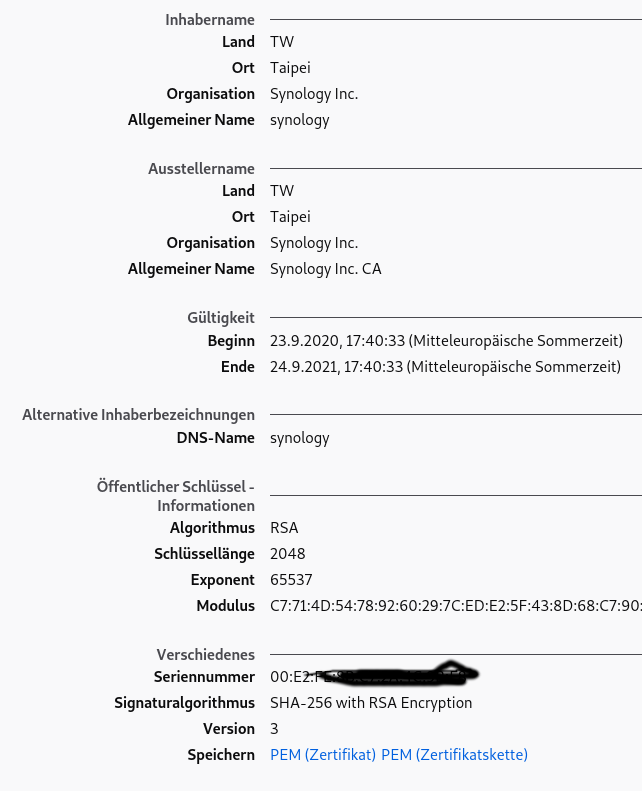

How does your certificate look like / what is the content of it ? Does it contain the servers IP address and the IP address of your server changed ? Or does it contain the servers FQDN ?
Sorry, I’m not really understanding what to do.

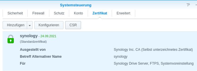

I downloaded the certificate from the web browser and have imported it to the java trust store. As I understand the dns name is synology. I don’t know if it is changeble somehow. I’m addressing it with a static IP address I gave him.
I found a button called CSR .
Does you mean, I should create a new certificate and it will not work with the current certificate?
The workflow would be the same after the creation; download the certificate and install it in the java trust store?
Depending which options you have when configuring the certificate. Checkout the Button “Konfigurieren” and look for “Common Name”/CN/“Zertifikatsname” and for “(Subject) Alternative Name”/SAN/“Alternativnamen”. One of those names must be the name or ip you access from openhab. Then i’d expect to get a fresh self signed certificate and the import process is the same. Else we need to create an own CA, but let’s try out that first.
