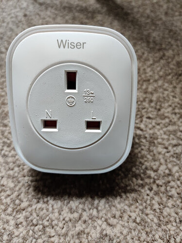

If you have one of the newer smart plugs (the little square ones, rather than the big repeater ones) do they have a serial number sticker on them somewhere?
I’m not sure if I’ve got the new or old version, but it doesn’t have a serial number on the unit itself
OK, that’s helpful to know. The solution for smart plugs is probably to use the discovery function in paperui to find the serial number (or peek at the json if you’re technically inclined) if you want to configure everything with .things files.
For reference that’s the only style of plug they’ve ever sold.
If you requested a free range extender back when they first launched the wiser system, they sent you one of these (or in my case, 2):
To start with they were just dumb range extenders, although the soft button on the side (glowing red in the picture) did activate a relay to toggle the socket on and off, however when the hub firmware was updated to add smart plug support, these plugs magically gained smart functionality (if you remove and re-join them) :slight_smile:

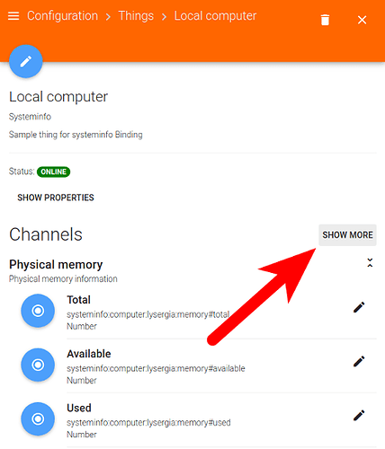

Quick question: is it necessary to add the Wiser things manually to expose all of the channels?
I ask because I added the things via PaperUI and then items via files but I do not see any battery voltage channel in PaperUI for the TRVs, only Battery level. Am I missing something?
Yes you miss something :smile:
courtesy to @wborn: [SOLVED] Milestone 4 - SystemInfo Issues - #9 by wborn
