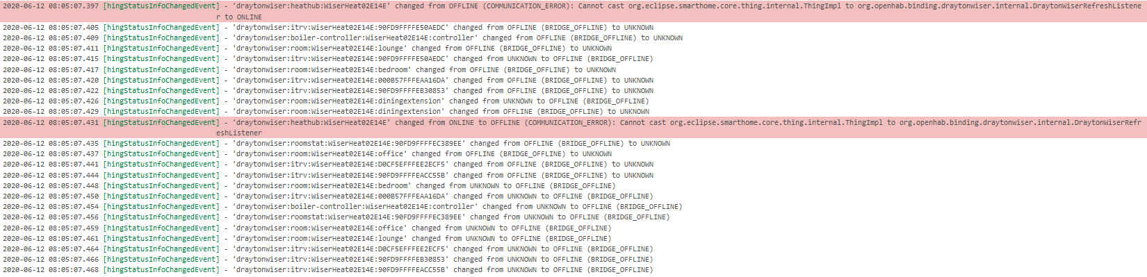

Before I had even had chance to manually add things this is in the event log
2020-06-12 11:09:48.128 [hingStatusInfoChangedEvent] - 'draytonwiser:heathub:WiserHeat02851D' changed from UNINITIALIZED (HANDLER_CONFIGURATION_PENDING) to INITIALIZING
2020-06-12 11:09:48.213 [hingStatusInfoChangedEvent] - 'draytonwiser:heathub:WiserHeat02851D' changed from INITIALIZING to UNKNOWN
2020-06-12 11:09:49.942 [hingStatusInfoChangedEvent] - 'draytonwiser:heathub:WiserHeat02851D' changed from UNKNOWN to ONLINE
2020-06-12 11:09:49.948 [me.event.ThingUpdatedEvent] - Thing 'draytonwiser:heathub:WiserHeat02851D' has been updated.

When uninstalling the binding, it fails to cleanly uninstall leaving the binding visible and the wait icon just circling on the addons/binding page of paperui. Here are the new lines added to the event log

It is in and so far running. I am getting a communications error to a Room, but to be fair, the room has been defined as per the wiser app, but does not have any TRV assigned as I do not have the serial number to hand. The auto detection solved this issue, is this a bug or has auto detect been removed?
Auto detection has not been removed. I’ve added some debug logging to the binding and uploaded a new kar file. If you enable debug level (log:set DEBUG org.openhab.binding.draytonwiser) and trigger discovery you should see it should find devices.
The room now has the TRV assigned and I can see the TRV fine. The Room is showing in the control panel and has temperatures, but remains as OFFLINE (COMMUNICATION_ERROR) in the Thing panel.

Didn’t even get to the new kar file and this appears in the log

And with the new kar and a search these messages arrive just before the exception, it ties with what I saw initially that the hub was found okay but no connected devices.
I’ve updated the kar. It could not find the humidity value. I’ve also added an extra logging on level TRACE that will return the raw result returned by the api. If you think it’s missing some data or doesn’t report all data in channels you can send me the log via DM.
The 500 error is probably unrelated to the binding. Maybe the logging shows any additional information. It just looks like humidity is not available on your devices or isn’t reported.
