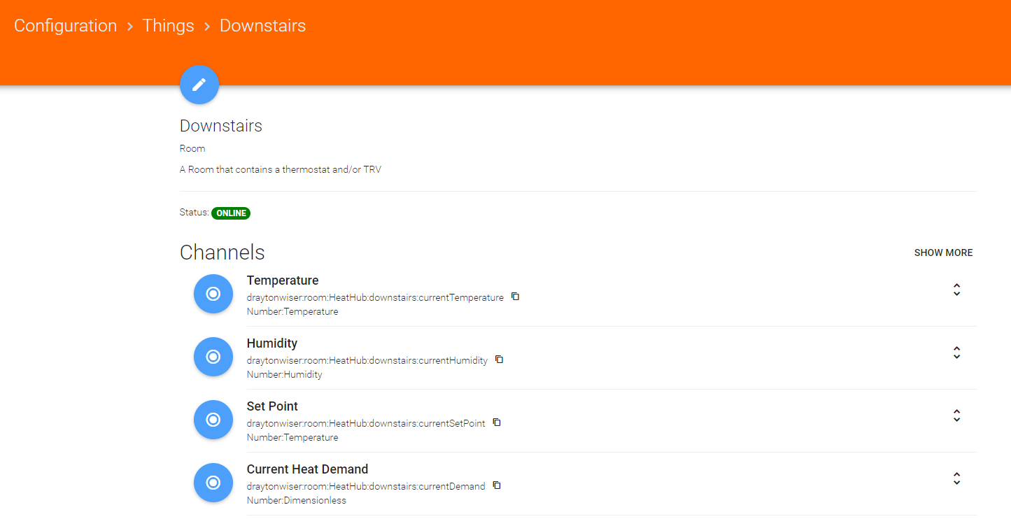

Can someone help me to get my thermostat humidity to show.
Everything else works fine I have an entry is my items file as;
Number:Humidity Landing_humidity “Humidity [%.0f %%]” (GF_Landing) [“Humidity”] {channel=“draytonwiser:room:HeatHub:Landing:currentHumidity”}
and it appears as a channel in PaperUI for both the room Landing and Landing Thermostat however when I go to make a link there is no entry for anything relating to humidity.

I have a Number item that looks the same as yours.
Number downstairs_humidity “Downstairs Humidity [%.0f %%]” [“Humidity”] {channel=“draytonwiser:room:HeatHub:downstairs:currentHumidity”}
