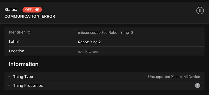

i am trying to get my ne Dreame L10s Pro Ultra Heat online in my Openhab 4.0.2. Unfortunately the Xiaomi binding always say “Offline”.
Have anybody any advice for me to get it working?
It is configured as unsupported thing and also with the autodetection… both are not working and are showing the same error…
In the log:
2024-05-11 23:00:56.704 [WARN ] [core.thing.internal.ThingManagerImpl] - Disposing handler for thing 'miio:generic:2F113844' takes more than 5000ms.
2024-05-11 23:01:01.723 [WARN ] [core.thing.internal.ThingManagerImpl] - Disposing handler for thing 'miio:generic:2F113844' takes more than 5000ms.
2024-05-11 23:01:02.653 [WARN ] [.core.thing.binding.BaseThingHandler] - Handler MiIoGenericHandler tried updating the thing status although the handler was already disposed.
Any idea?
To anybody with the same problem…
The solution is to switch from “direct” to “cloud” and enter the country of the server…
