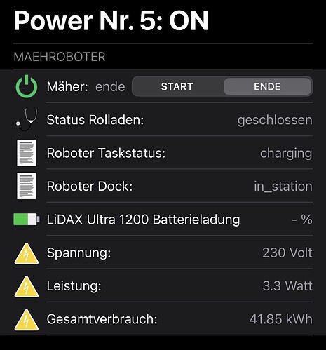

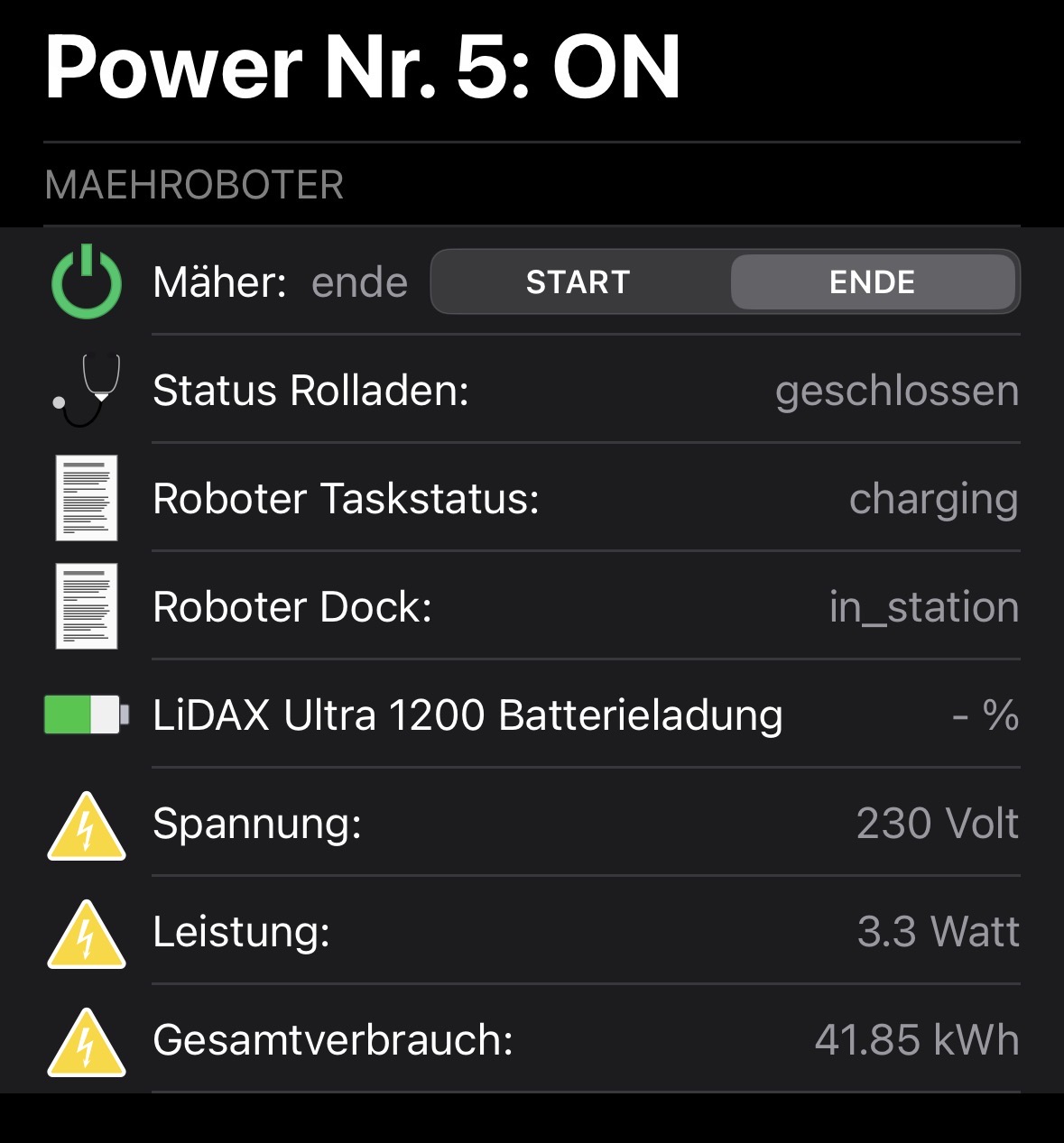

Thanks a lot for your binding :heart:
Your release was just in time for my project - so I didn’t need to work around with synchronised schedules for the roller shutter in OpenHAB and for the mower in the MovaHome app. Your binding is doing great so far, of course there are some channels undefined, but at the moment I am totally fine using the channels command, docking state and task state. I’m am using it with a Mova LiDAX 1200 by the way.
DIY garage with roller shutter and WLED animations:
Kind regards
