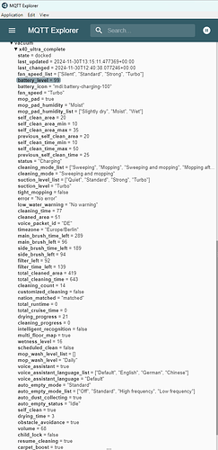

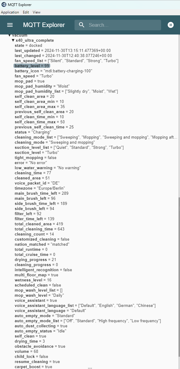

Done. “Lean job”.
  • Install VMM on my Synology DS216+II manually (no longer officially provided)
  • Setup HA vitual machine (my openHAB Pi has only 2GB RAM)
  • install all that necessary HA stuff (HACS, Studio code server, setup mqtt_statestream)
Just half a day later:
mqtt
Thing mqtt:topic:mosquitto:dreame "MQTT Dreame" (mqtt:broker:mosquitto) {
    Channels:
      Type string :  Dreame_status                        [ stateTopic="homeassistant/vacuum/x40_ultra_complete/status"]
      Type number :  Dreame_Battery    "Dreamxe Battery"  [ stateTopic="homeassistant/vacuum/x40_ultra_complete/battery_level"]
