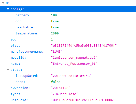

Here is a full example of my Window/Door-Sensors (Xiaomi) with Deconz.
In the Things-File you can see how I add other Xiaomi Sensors.
Maybe it helps.
Rest API http://phoscon/api/API-KEY-INSERT-HERE/sensors:
THINGS-File deconz.things
 Bridge deconz:deconz:homeserver [ host="127.0.0.1", apikey="YOUR-API-KEY-INSERT-HERE" ]

     openclosesensor     EntrancePostsensor01       "Entrance_Postsensor_01"           [ id="8" ]

// Windowsensor Xiami
Contact              EntrancePostsensor01Open           "Open/close"     (OU_Entrance) {channel="deconz:openclosesensor:homeserver:EntrancePostsensor01:open"}
DateTime             EntrancePostsensor01LastUpdated    "Last updated"    {channel="deconz:openclosesensor:homeserver:EntrancePostsensor01:last_updated"}
Number               EntrancePostsensor01BatteryLevel   "Battery level"   {channel="deconz:openclosesensor:homeserver:EntrancePostsensor01:battery_level"}
Switch               EntrancePostsensor01BatteryLow     "Low battery"     {channel="deconz:openclosesensor:homeserver:EntrancePostsensor01:battery_low"}
Number:Temperature   EntrancePostsensor01Temperature    "Temperature"     {channel="deconz:openclosesensor:homeserver:EntrancePostsensor01:temperature"}
