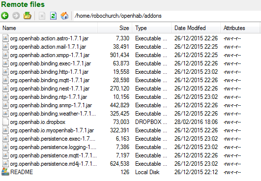

I love the idea of being able to synchronise the Openhab folder with DROPBOX in order to use OpenHAB Designer on my server, but I’m finding great difficulty getting the DROPBOX IO addon integrated. I haven’t ever seen the “o.o.i.d.i.DropboxSynchronizer” entries described in Dropbox IO · openhab/openhab1-addons Wiki · GitHub in the openhab log file, even though I’ve put the DROPBOX add-on in the add-ons folder

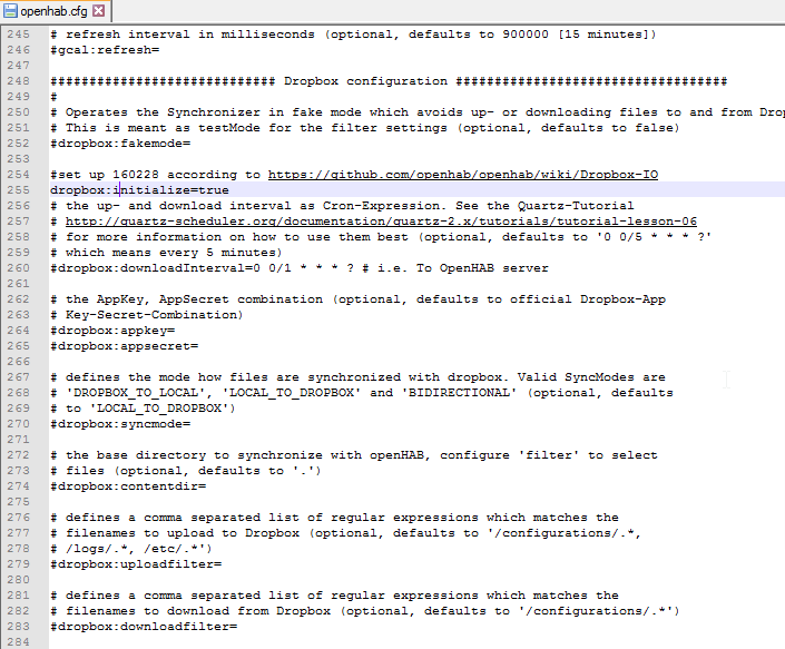

And added the dropbox:initialize=true line into the config file

I would still very much like to get the DROPBOX IO sync working. It seems most strange that I get none of the expected entries in the log file that are promised in the guide to the binding (extract from Dropbox IO · openhab/openhab1-addons Wiki · GitHub below).
Could it be that there is something not listed in the steps described in the guide that the binding relies on for start up, and that is missing from my configuration? I think that could be why I don’t see the synchronizer entries:
Step 2 is issued by openHAB automatically on startup. You will find some log entries (also in the console) like this:

If you don’t see what the wiki pages tells you what you should see at startup the problem is almost certainly that the binding is not installed correctly. Verify that you have the right jar file for the binding in your addons folder. If you do, try downloading and installing it again in case it got corrupted the first time (unlikely but it has happened).

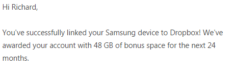

Thank you, Rich for your really speedy and helpful replies. That was indeed the problem. I had selected the wrong dropbox IO binding. Now it matches, the authentication code is available. Just waiting for the synchronisation to begin. Good stuff.
Interesting to see OpenHAB is seen as a Samsung device! It was worth making this DROPBOX connection because my labours have been rewarded with a lot more free space to develop the configuration some more and store those log files:
