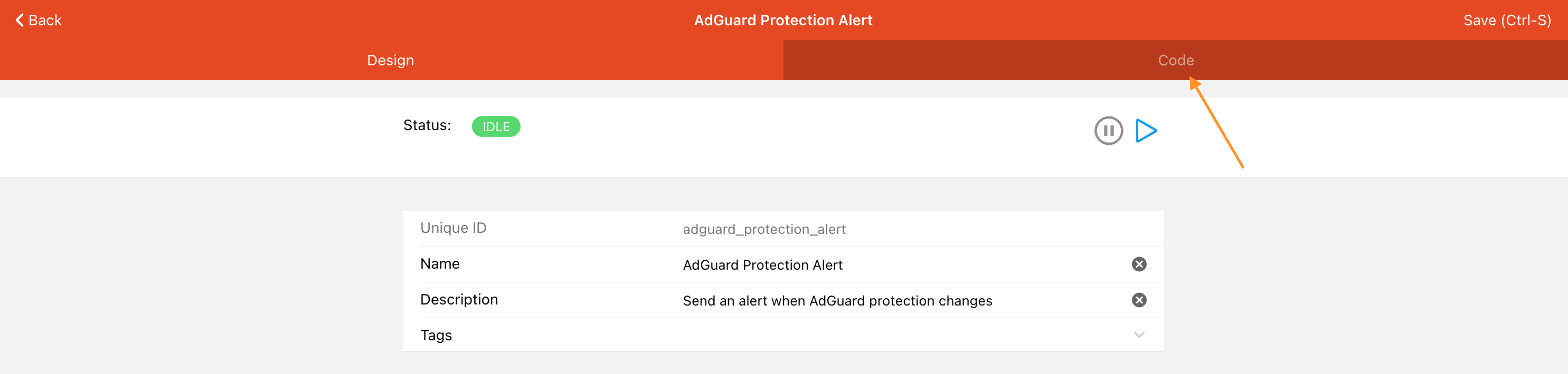

Try not to post screen shots where a code tab is available. This is particularly important with a rule because a screen shot doesn’t show the full context (e.g. triggers).
Post the contents of the code tab with code fences.
code goes here

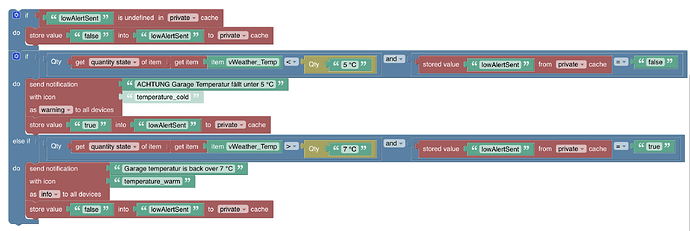

my code is
if (cache.private.exists('lowAlertSent') === false) {
cache.private.put('lowAlertSent', 'false');
if ((items.getItem('Temperature_Sensor_13_Temperature').quantityState.lessThan(Quantity('5 °C'))) && (cache.private.get('lowAlertSent')) == 'false') {
actions.NotificationAction.sendBroadcastNotification('ACHTUNG Garage Temperatur fällt unter 5 °C', 'temperature_cold', 'warn');
cache.private.put('lowAlertSent', 'true');
} else if ((items.getItem('Temperature_Sensor_13_Temperature').quantityState.greaterThan(Quantity('7 °C'))) && (cache.private.get('lowAlertSent')) == 'true') {
actions.NotificationAction.sendBroadcastNotification('Garage Temperatur ist über 7 °C', 'temperature_warm', 'info');

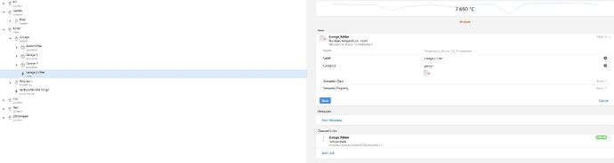

Thing code and created a item from this thing
UID: onewiregpio:sensor:ebbe24125a
label: Garage_Fühler
thingTypeUID: onewiregpio:sensor
configuration:
gpio_bus_file: /sys/bus/w1/devices/28-adab571f64ff/w1_slave
refresh_time: 15
precision: 2
location: Garage

That’s part of it and it’s useful. But I want the YAML code for the full rule.
It will look something like this:
configuration: {}
triggers:
- id: "1"
configuration:
itemName: AdGuard_Protection
state: ON
previousState: OFF
- id: "2"
configuration:
state: OFF
previousState: ON
conditions: []
actions:
- inputs: {}
label: Send Alert
description: Uses the alerting library to send an alert level message
configuration:
type: application/javascript
script: >
var {alerting} = require('rlk_personal');
var logger = log('AdGuard');
alerting.sendAlert('AdGuard Protection is now ' + event.itemState.toString().toLocaleLowerCase() + '.', logger);
type: script.ScriptAction
Notice how it shows the triggers, conditions and actions. For a rule using Blockly it will show the XML that defines the graphical blocks as well as the JS code the blocks “compile” into.
In short, it shows everything .

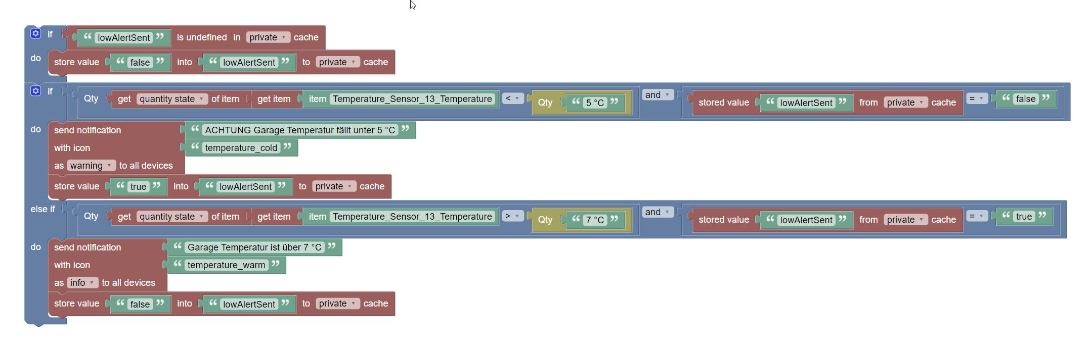

okay i see my problem
I have add this blocky to script page.
I add the blocky to my rule and said, when item state updated then run script and it works.
This was my first blockly.
See my code.
Thanks for help me to coding this

id="`(qj1CX8bm$n,54m#]UY"><field name="TEXT">10 W</field></shadow><block
type="text" id="`(qj1CX8bm$n,54m#]UY"><field name="TEXT">7
°C</field></block></value></block></value></block></value><value
name="B"><block type="logic_compare" id="|~,ginrm.0I1zZobpi~A"><field
name="OP">EQ</field><value name="A"><block type="oh_get_value"
id="9p7gV^dTVDrKs_JZq{j6"><field name="cacheType">.private</field><value
name="key"><shadow type="text" id=":zzBWo5]a@KM-CRm#PN#"><field
name="TEXT">key</field></shadow><block type="text"
name="TEXT">lowAlertSent</field></block></value></block></value><value
name="B"><block type="text" id="y.M)uaBSBhG#kfUu.COg"><field
name="TEXT">true</field></block></value></block></value></block></value><statement
name="DO1"><block type="oh_sendBroadcastNotification"
id="Nx6{JM=D(;`:*(P`N;L#"><field name="severity">info</field><value
name="message"><shadow type="text" id="biaROc)8VYP.s2t/_*nc"><field
name="TEXT">message</field></shadow><block type="text"
id="biaROc)8VYP.s2t/_*nc"><field name="TEXT">Garage Temperatur ist über
7 °C</field></block></value><value name="icon"><shadow type="text"
id="/Iye=h+0e#jEBnz0b931"><field
name="TEXT">temperature_cold</field></shadow><block type="text"
name="TEXT">temperature_warm</field></block></value><next><block
type="oh_store_value" id="tLwb!T#o)%+M]C5,~/M9"><field
name="cacheType">.private</field><value name="value"><shadow type="text"
id="/E{*RsyE]]t/*G|yp2-2"><field
name="TEXT">value</field></shadow><block type="text"
name="TEXT">false</field></block></value><value name="key"><shadow
type="text" id="RYQE}?o_uY]NRDCu3*(0"><field
name="TEXT">lowAlertSent</field></block></value></block></next></block></statement></block></next></block></xml>
script: >
