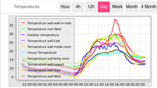

Temperature is relative. Different results when measured on the roof (also heated up by the sun); each side of the house will be different. Here my sensors placed at all four sides of the house as an example for my claim…
You may ask a search engine “where and how to properly install an outdoor temperature sensor like meteorology would do it” for the scientific method.
I can only guess as you haven’t pointed out what the sensor is used for. Assuming it is outdoor temperature, it should be installed in a sun-shaded, yet well-ventilated enclosure, ideally a couple of metres away from the house.
