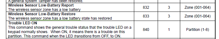

There is a new version of the Envisalink firmware (205) that adds reporting of which wireless zone has a low battery. The codes are detailed in the latest version of TPI Programmer’s Document:
It just so happens that I had a low battery in one of my sensors the other day so I thought I would look into publishing the low battery message (including the zone #) to PANEL_TROUBLE_MESSAGE at a minimum.

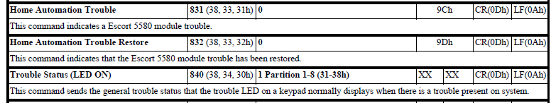

However I quickly ran into a roadblock in that the 832 code was already implemented in the binding for trouble reporting of a different module as described in the IT-100 developer guide:
It seems problematic that Envisalink has re-used a code that was already used by the IT-100 for different purposes. From a cursory review of the existing functionality, it looks like the messages from the bridge handler should all be the same no matter which bridge handler is actually used. Any ideas on how to proceed?
