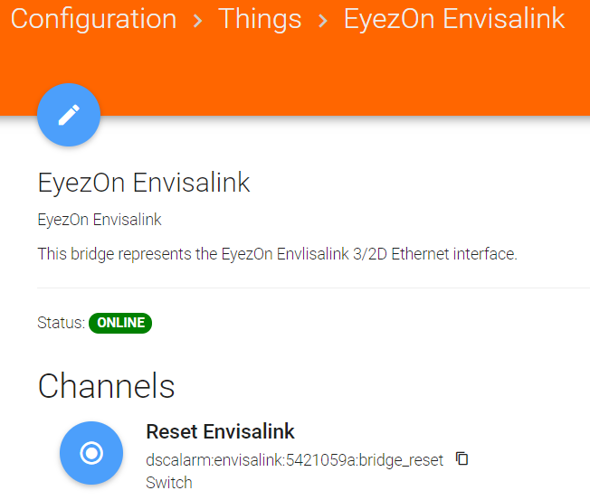

It should be here, right? I only see the reset channel for the bridge. Or is this not the right location to find it?
Yes, that is the correct location. Not sure why it isn’t showing up. What is your item setup in the item file?
Item file looks like this, but that doesn’t control the existence of channels, does it?
String SEND_DSC_ALARM_COMMAND "Send a DSC Alarm Command" {channel="dscalarm:envisalink:5421059a:send_command"}
