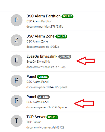

Here, you can see the things in Paper UI. The red arrows point to the envisalink bridge and panel that don’t work:

Hello @lysol,
You can’t have 2 bridges for the same DSC system. They are probably conflicting with each other. You can use the TCP Server bridge with an Envisalink, but it might be better to just use the Envisalink bridge. Hope this helps.
I should have put more emphasis on that bridge. I created that bridge first and tried to make it work without success. Then I went with the TCP bridge and everything came online.

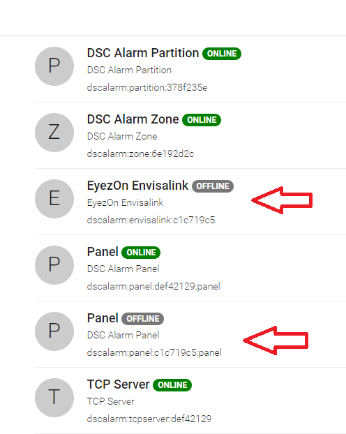

This is all I have for Things in Paper UI related to the DSC Alarm again:
