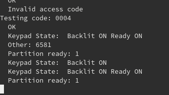

script started running but then stopped after testing 0004.
What did I do wrong? How do I make sure the script exits installer code? I’m afraid to kill it.

Well, found that I have a keypad lock after 4 unsuccessful attempts.
I was able to add a sleep after every 4th entry. the sleep works but after trying one more code it fails.
still working on it.
I’d be very surprised if a security system didn’t have a simple safeguard against brute force passcode cracking - four wrong attempts, get locked out for N minutes.
Yep, that’s what i found out and added a work around.
I might just need to factory reset my system.
