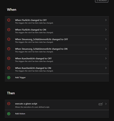

The triggers for the rule are made in the gui and the dsl rule which i posted is below the “then” part:
Rules OH3

The rule shown triggers on any of X,Y, Z. Then it figures out which it was, X say. Then it acts on X without any reference to Y or Z.
There’s no disadvantage to having separate rules for each X or Y or Z case, there is no pricing per rule.
It does look like it should logically break into three rules though, not six.

One other note, when posting a rule to the forum, please click on the Code tab and paste the text. Screen shots and pictures of rules are generally useless to us and they are never complete.

Thanks, didn´t know that in the code part contains the triggers choosen in the gui. That was the reason for the screenshot.
