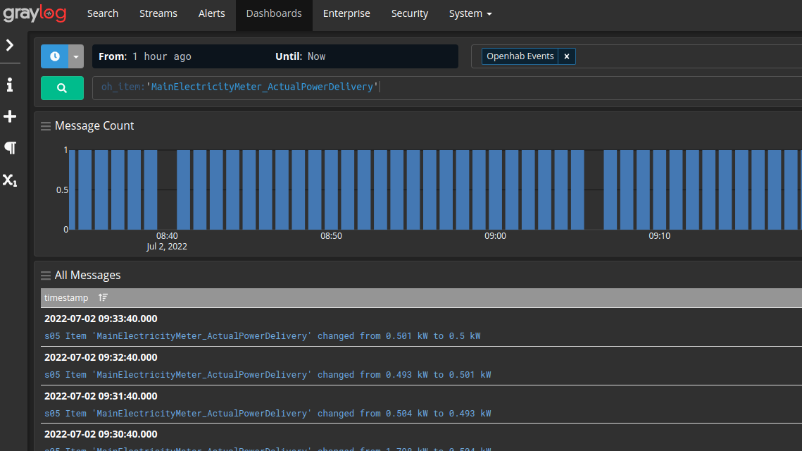

I receive the data every 1 minute but notice intermittent drops in my graph.
Now and then event seem to missing.

So the binding is updating the “emeter_actual_delivery” channel state, but then the Item ‘MainElectricityMeter_ActualPowerDelivery’ change update is not happening/triggered consistently.
Please note that an “update” is not necessarily a “change”. If a channel receives an update of 0.42, and the linked Item already has a value of 0.42, the item will not register a change. This is normal OpenHab behavior.
You probably have a rule triggering “when Item x changed” to write to your log server. Change that to “when item X received update”.
Indeed. I overlooked that one.
Thanks for your help.
