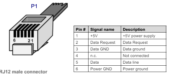

I have a Siemens IM350 smart meter which has a DSMR P1 V3.0 RJ12-Interface.
The power provider gave me the encryption code.
I connected the RJ12-Interface via an USB-to-TTL serial adapter to the Raspbery Pi 4b.
I can see the encrypted data via /dev/ttyUSB0 so I installed an actual OH2 and the DSMR-binding altough I am from Austria.

I’m using Austrian T210-D as well, tried now to connect as shown in the pic below. But i do not even get power to the ESP.
So for me the question, is P1 normally enabled by default or does the provider remotely enable as soon as the client requests it…
OR does the Pinout vary depending on the country / customizations. Because my operator (EVN) provides following PDF on the internet. Which brings in another level of confusion. Here it’s clearly stated that 1 does not provide 5V and even more strange there is a 2wire MODBUS communication depicted.
I’ve seen people post that the T210-D is using the same NL slimme meter cable…but how can this be the case when here its written as MBUS and not serial RX/TX.
Thanks for reading and i really hope that someone can clarify my confusions.
Many Thanks
Norbert

The p1 connectors Im aware of are 4 pins RJ11.
While it mentions 5volt it’s not always available and it’s recommend to use an external power supply. This can be 5v via USB if it’s a USB to serial cable.
It might be the provider needs to enable the port. But this seems country specific. But I don’t know if that is the case for you.
